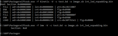

I need to generate a simple secure binary file for testing. I follow the steps in the document "i.MX RT1060 Manufacturing User's Guide" but the generated file is empty.
In the attachments I send a package with the results I achieved.
The documentation states that:
"Typically, all the application image paths are provided in this section. Currently, the ELF file and SREC file are supported for i.MX RT Bootable image generation"
But how to generate srec or elf files as MCUXpresso can only generate .s19 files ?
Binary description file for bootable image creation :
options {
    flags = 0x00;
    startAddress = 0x60000000;
    ivtOffset = 0x1000;
    initialLoadSize = 0x2000;
sources {
    elfFile = "evkbimxrt1050_iled_blinky.bin";
section (0)
 Command:
elftosb.exe -f imx -V -c imx-flexspinor-normal-unsigned.bd -o ivt_evkbimxrt1050_iled_blinky.bin
Binary description file for secure binary creation:
sources {
	myBinFile = "ivt_evkbimxrt1050_iled_blinky.bin";
section (0) {
	load 0xC0233007 > 0x2000;
	enable flexspinor 0x2000;
	erase 0x60000000..0x60010000;
	load 0xf000000f > 0x3000;
	enable flexspinor 0x3000;
	load myBinFile > 0x60001000;
Command:
elftosb.exe -f imx -V -c test.bd -o evkbimxrt1050_iled_blinky.sb
and the result is as follows:

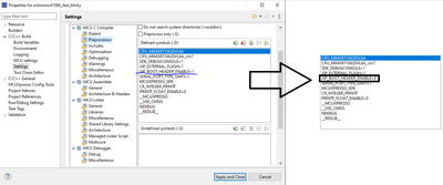

  When you generate the .19, please don't contains the FCB.
  XIP_BOOT_HEADER_ENABLE =0
  Do you do it like this?

I checked the commands in the document you recommended. To generate a *.sb file it needs to pass the argument "kinetis" instead of "imx".
Kamil

Hi @kamilm ,
  You are right.
  When generate the .sb, you need to use the kineits, not the i.mx
elftosb.exe -f kinetis -V -c ../../bd_file/imx10xx/program_flexspinor_image_qspinor.bd -o boot_image.sb ivt_flexspi_nor_hello_world_nopadding.bin

kamilm
Hi Kerry !
Generated files are ok.
However, generating a bootable image from an .s19 file does not work. Only when the .bin file is specified, the bootable image is created.

kamilm
Hi Kerry,
Thank you for help!
I changed the value of the symbol XIP_BOOT_HEADER_ENABLE =0
Now everything is OK!
