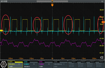

Hi,man
   I used eFlexPWM for motor control. when I used EXT_SYNC signal , I find some pwm update problem in , In pic red circle, you can see pwm change Incorrect。
another pic show correct pwm update, NOT IN EXT_SYNC mode.
So, when I used EXT_SYNC mode,
__________________________________________________________________________________
there is the pwm config IN EXT_SYNC mode , Can you help me find what wrong?
Thanks!

I'm usign LPC5536 and I'm trying to sychronize the two eFlexPWM units via EXT_SYNC signal. I have seen a strange behaviour like you, with time delay in the syncronization!! Also in my opinion the EXT_SYNC mode of the eFlexPWM has some design problems. Have you solved the issue? Thank you
1,815 Views
xfmcux
I think it's a problem with the PWM update and SYNC update mechanisms. The values of SM[x].VALx need to be above -3 for normal operation.
2,397 Views

I recommend you refer to the app note AN12200 (Associated File: AN12200SW), which describes a dual servo application with the RT1020, it uses eFlexPWM just like the RT1052. Here it is described how the EXT_SYNC signal of PWM1 triggers the initialization of the counters of PWM2 to achieve a 180° lag between the PWM waveforms of the two motors.
Hope it helps you.
Have a nice day!
2,234 Views
xfmcux
Yes, I referred to the code of AN12200 to modify the CTRL2 register, but it did not solve my problem. I think the EXT_SYNC mode of the eflexPWM module may have design problems itself, or it needs special handling when used.
