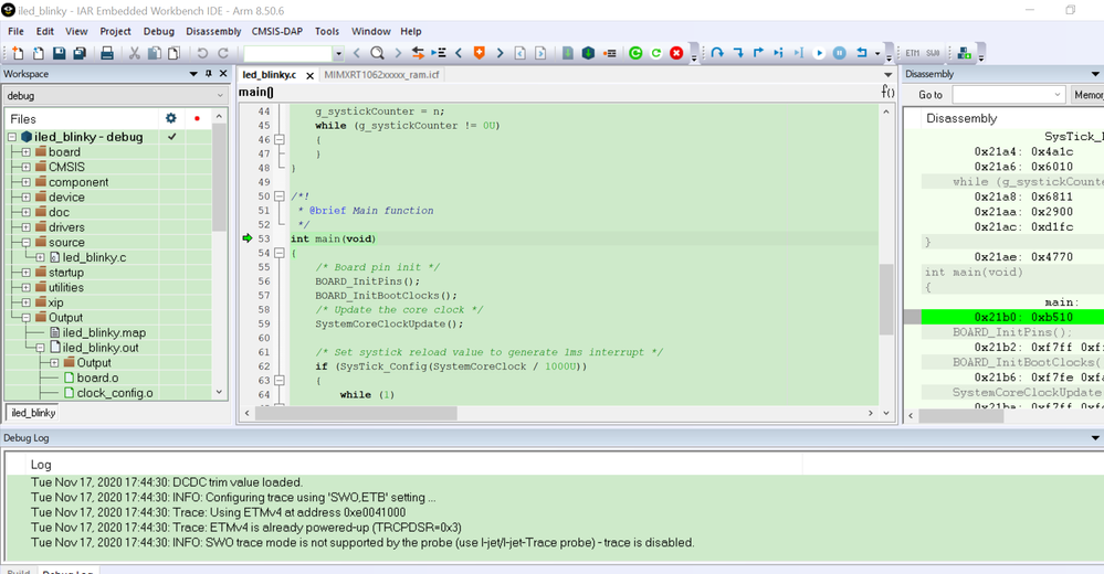

Hi vinaymanikkoth,
Give me your workspace picture, it should be debug:
If you choose this one the code will be download to the internal TCM, when you download it, what's the issues you are meeting?
Still the same debug log?

Hi vinaymanikkoth,
   Follow me try again:
1. SW7 1-0FF, 2-OFF, 3-OFF, 4-ON
2. debug your iled_blinky project again:
My log:

In fact, this is no relationship with your external hyperRAM, it should work.
Wish it helps you!
If you still have questions about it, please kindly let me know!
Kerry
