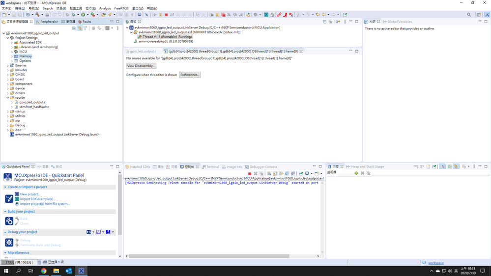

I encountered a problem when I tried to use MIMXRT1060-EVK to develop. I tried to use on-board Freelink downloading my code or example code into the board by MCUXpresso. MCUXpresso display the following error message:
Driver V.2 dynamic startup failed - driver Init provided no flash parameters
Flash Driver V.2 startup failed - rc Ef(55): Dynamic flash driver startup failed to provide flash parameters.
Terminate (0x0, 0x0, 0x0) status 0x40 - driver reports init failure - EXTSPIJ driver rc 20107 (0x4E8B)
chip initialization failed - Ef(55): Dynamic flash driver startup failed to provide flash parameters.
failed to initialize flash driver MIMXRT1064.cfx
I have checked switch of the BOOT_CFG is correct to choose QSPI flash, and the project of led blinking is running at the board.

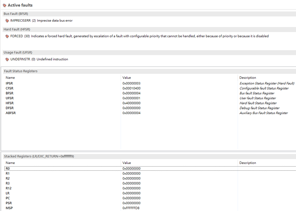

I tried to change the driver become MIMXRT1060_SFDP_QSPI.cfx to slove this problem, and the problem was been solved but the problem become "active fault".
Where can I find the proper driver to fix this problem?

3) The "Active faults" is the fault at MCUXpresso. (Note: This problem happened when "PROGRAM FLASH" is 0x7000_0000 or 0x6000_0000 and "Driver" of "PROGRAM FLASH" is MIMXRT1060_SFDP_QSPI.cfx)pastedImage_8.png

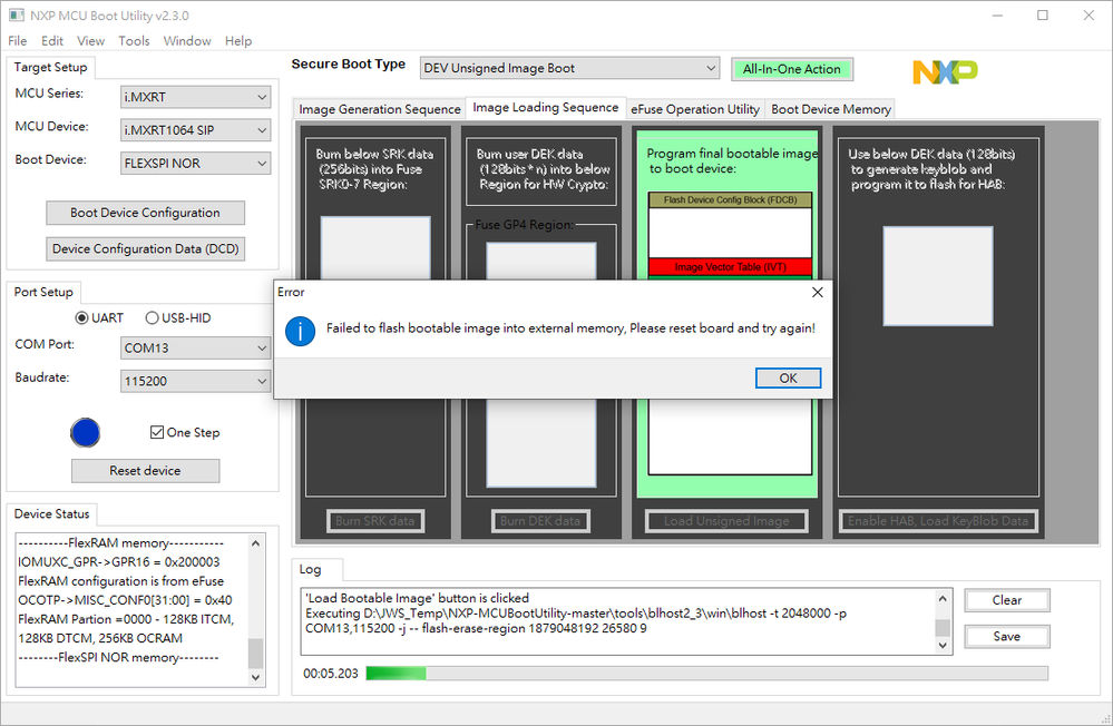

b) I had tried to use "Serial Downloader", but appear the following error message. (Note: {SW5, SW6, SW7} = {0x0, 0x0, 0x1}, USB cable connected at J41/the socket of the nearest Freelink.)

1)  Firstly, MIMXRT1060_SFDP_QSPI.cfx is not suited for the i.MX RT1064.
2) According to your reply, it seems that the NXP MCU Boot Utility tool can establish a connection with the MIMXRT1064 board. However, it fails to program the image to the i.MX RT1064 after clicking All-In-One-Action icon. Is it right?

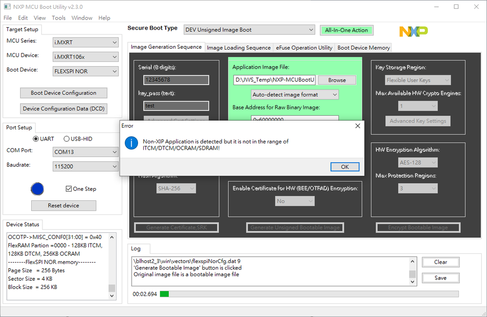

2) Yes, but my board is MIMXRT1060-EVK and the chip is i.MX RT1062.
I had tried the trick to solve the error by updating MCUXpresso IDE and SDK
a) I can access debug console success after updating, but the problem became as shown below.
