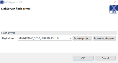

Well, I finally made a bit of progress on this.
I found a post on hyperflash and the eval boards that mentions that in addition to using the
1050 eval hyperflash driver on the 1062 eval board,
one needs to change the contents of the evkmimxrt1060_flexspi_nor_config.c file.
I tried this on the eval board and our target hardware but wasnt able to make things work.
However, it got me to thinking.  I tried running the flash tool from mcuxpresso and used the
1050_connect script on the target hardware.  I was able to successfully program the flash on
our target board.  I have confirmed that the contents are correct.  I cant program directly from
MCUXpresso, nor can I debug from there, but I can burn the flash.  After doing so, I switched
programmers to a JLink, and used NXP MCUBoot Utility to connect to the rom, which presumably
sets the correct registers for accessing hyperflash.  I then set the PC and stack pointers by hand from
JLink commander, and was able to run my program from flash.
So clearly, the flash is working.

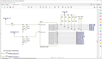

fischer_larry
Here are the hyperflash connections for this board 
9,428件の閲覧回数
jeremyzhou
Thanks for your reply.
After having a brief review of the attached schematic, I think it's right.
So I was wondering if you can demonstrate the steps of programming in detail, and in the custom board, whether the S26KS512SDPBHI02 would work as the boot-up flash device which likes the QSPI in the MIMXRT1060-EVK board.
Looking forward to your reply.
TIC

fischer_larry
Actually, Im waiting on a HW guy to ID the exact resistors.  I dont have a layout file that I can read and the labels on the board are not exactly obvious to me.  Can you point me to a picture that shows which are the resistors to change?
