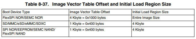

Since this is a program file (and not flashloader), it needs to be loaded into Flash whose address is 0x60000000. Also NOR FlexSPI offset is 0x1000 according to the reference documentation.

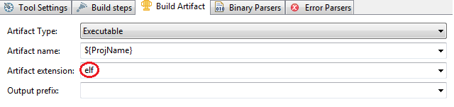

The .elf file (attached) was generating in MCUXpressor by changing the artifact extension from 'axf' to 'elf'.

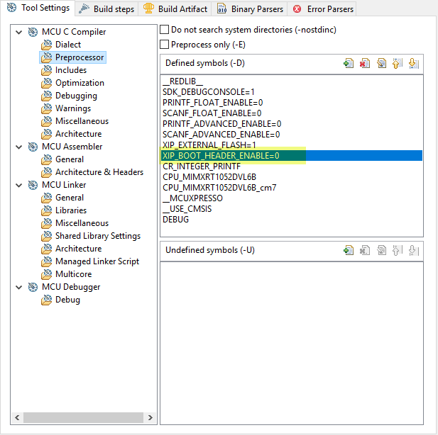

 This happens because the project already has a Boot header, you have to disable this with the Preprocessor symbol XIP_BOOT_HEADER_ENABLE in the project settings, please change it to 0.

Thanks Jorge, that helped. I can see both output.bin and output_nopadding.bin being generated now.
