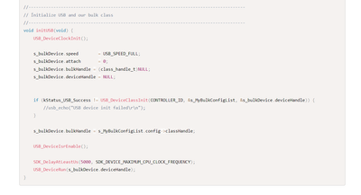

I have for a long time been wanting to do a Custom USB class driver on the RT106x devices. I have been put down by the, seemingly, complex structure of the NXP USB example code. While I still don't think the samples in the SDK are "the best" out there, they do seem to work, and at least provide a starting point. Several people here have been looking for an implementation of a Custom USB class device, myself including. I have a Bulk device running on a number of NXP processors (LPC2148, LPC2458, LPC1788, LPC54628 etc) and I wanted to have the same running on a RT1064.
Finally that seems to be working. I got some pointers from the user @markdodd  in the process, thanks a lot!
Now, there is ABSOLUTELY NO GUARANTEE that the code is correct, the only guarantee I can give is that there is probably something (or a lot) that could be made much better/smarter/faster. But, this at least works for me as it is. I will continue testing and fixing stuff, when I find something that can be improved, I will post it in this thread.
You are absolutely free to use the code in any way you see fit (as long as you follow the rules/guidelines from NXP). However, if you spot something bad/wrong etc, PLEASE let us know so we all benefit from this!
PLEASE remember that ALL data that you want to receive/transmit over USB MUST be in non-cached memory !
This device creates a Custom USB class using VID=0xFFFF, PID=0x4712 and Class=0xFF (Vendor specific)
The USB class has one interface (interface 0) and one configuration (configuration 1).
It has 4 endpoints, 1 OUT and 3 IN endpoints. In practice, it uses the OUT and one of the IN endpoints as a "channel" for a request/response type command interface. The two last IN endpoints are used for sending log messages and wireshark compatible frames (when the target device has a TCP/IP stack embedded that it wants to send debug traffic from).
Tested on USB0 on i.MXRT1064. I'm not sure how much needs to be done to have it work on USB1, I have tried to leave the code that was in the CDC sample from NXP, but no guarantee!
On the PC side I use libusbdotnet library (and C#) for communication.
The two most important modules is show below, all code is in a zip file attached.

// BulkUSB.c                                                       20210405 CHG
// Based on NXP's CDC sample from SDK 2.9.2 by Carsten Groen ([email protected])
// This device creates a Custom USB class using VID=0xFFFF, PID=0x4712 and Class=0xFF (Vendor specific)
// The USB class has one interface (interface 0) and one configuration (configuration 1).
// It has 4 endpoints, 1 OUT and 3 IN endpoints. In practice, it uses the OUT and one of the IN endpoints as
// a "channel" for a request/response type command interface. The two last IN endpoints are used
// for sending log messages and wireshark compatible frames (when the target device has a TCP/IP stack
// embedded that it wants to send debug traffic from).
// Tested on USB0 on i.MXRT1064. I'm not sure how much needs to be done to have it work on USB1,
// I have tried to leave the code that was in the CDC sample from NXP, but no guarantee!
// On the PC side I use libusbdotnet library (and C#) for communication.
// Files added/modified from original SDK example:
//  Large changes:
//  	BulkUSB.c/h (many changes, based on virtual.com.c/h)
//		usb_device_my_bulk.c/h (many changes, based on usb_device_cdc_acm.c/h))
//  Minor changes:
//		usb_device_descriptor.c/h (many changes)
//		usb_device_config.h (changes marked with "CHG")
//		usb_device_class.c/h (changes marked with "CHG")

// Ínitialize USB and our bulk class
void initUSB(void) {
    USB_DeviceClockInit();
    s_bulkDevice.speed        = USB_SPEED_FULL;
    s_bulkDevice.attach       = 0;
    s_bulkDevice.bulkHandle = (class_handle_t)NULL;
    s_bulkDevice.deviceHandle = NULL;
    if (kStatus_USB_Success != USB_DeviceClassInit(CONTROLLER_ID, &s_MyBulkConfigList, &s_bulkDevice.deviceHandle)) {
        //usb_echo("USB device init failed\r\n");
    s_bulkDevice.bulkHandle = s_MyBulkConfigList.config->classHandle;
    USB_DeviceIsrEnable();
    SDK_DelayAtLeastUs(5000, SDK_DEVICE_MAXIMUM_CPU_CLOCK_FREQUENCY);
    USB_DeviceRun(s_bulkDevice.deviceHandle);

1. main() missed, is code below enough :
void main(void)
initUSB();
2. Is there is a driver for this example?
20,223 Views
carstengroen
Senior Contributor II
@yanz
Yes, you call the function initUSB() in the first file "BulkUSB.c", this is all that there is to it.
I have some code in C# for the PC side, however I can not share this. You will find samples on the net for the PC
