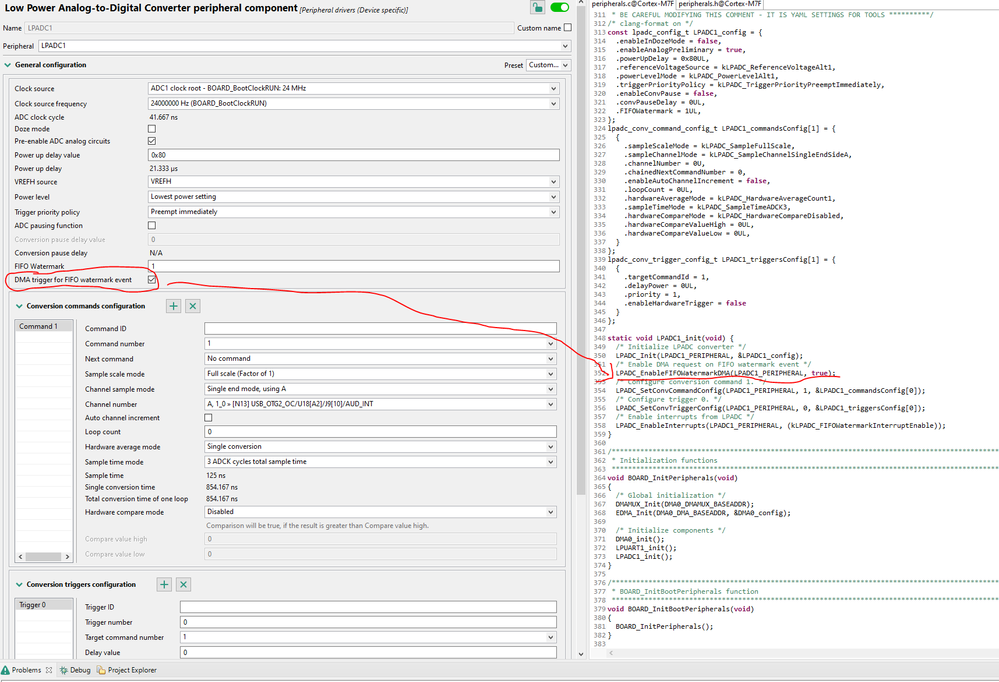

auftrag2021
HW: RT1170EVK
Target: move the RESFIFO from LPADC1 to dstAddr

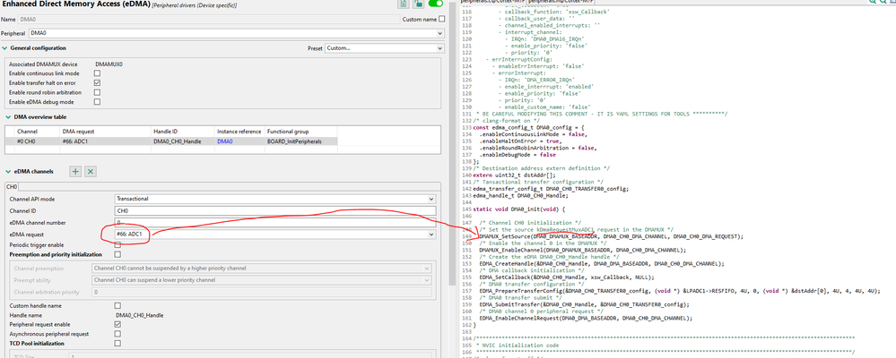

Configuration in eDMA:
Configuration in LPADC1
start LPADC1 per SW in Main()
LPADC_DoSoftwareTrigger(LPADC1, 1U);
The problem is, the callback from eDMA function was never called in my application. Why?
So far as I understand, I trigger the LPADC1 per SW, after the watermark is running out, the LPADC1 trigger the DMA request, then the DMA get the result from LPADC1->RESFIFO, because I set the Minor and Major both as 4-Bytes, the eDMA should activate the callback after 4-Byte is transfered, right? where do I do wrong?
p.s. I extra tested the eDMA alone with SW trigger (EDMA_StartTransfer(&DMA0_CH0_Handle);), the callback function worked pretty well. The eDMA itself has no problem.

auftrag2021
thanks for your attention.
the issue was solved, but not in your way. the DMAMUX was correctly configured.
The problem was, I did set the watermark as 1, when I change the value to 0. It's fine to trigger the callback function from eDMA

Hui_Ma
Sorry for the later reply.
Besides of initialize LPCADC1 and eDMA module, it also needs to config the DMAMUX.
Please refer below code just an example for your reference:
Wish it helps.
Mike
