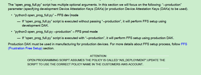

Thanks for the reply. I am trying to get the out of the box demo running and none of my changes are flashed on to the board. I'm just checking if reflashing the default binaries from nxp would solve the issue.
The ivaldi script contains two scripts. I wanted to know if i can just use the open boot programming for the purpose. And thanks for the email address. I'll share my observations from the serial console with the team to identify the issue.

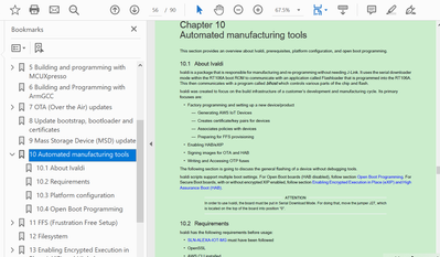

   From the Design guider, you can know, you can download the code in serial download mode:
Ivaldi is a package that is responsible for manufacturing and re-programming without needing J-Link. It uses the serial downloader
mode within the RT106A boot ROM to communicate with an application called Flashloader that is programmed into the RT106A.
About the script, just follow the document, Chapter 10 Automated manufacturing tools
In order to configure Ivaldi to use specific image binaries from Image_Binaries folder, 1. update “Scripts/sln_platforms_config/sln_alexa_iot_config/board_config.py” file
2. To program the firmware and artifacts, execute open_prog_full.py script.
