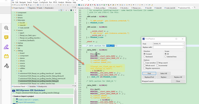

Hi @BrendaCG616 ,
  Please note, the SLN-SVUI-IOT is also using the external flash, and the external flash can't support RWW. So, if you want in the external flash do the flash operation, eg, write, erase, you need to copy the flash operation to the internal RAM. So, you need to copy your used flash file to the internal RAM, and run in the internal RAM.
   You can check the SDK demo, flexspi_polling, you can find the flash operation file all in the internal RAM.
Wish it helps you!
