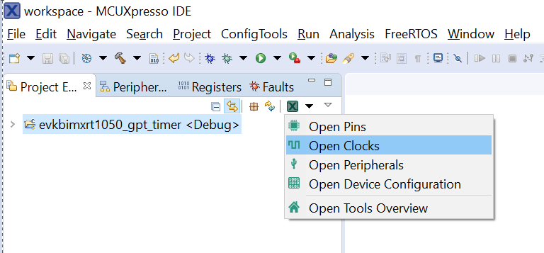

Unfortunately this will not be possible as there are many other peripherals that were designed around the 24 MHz oscillator. The SDK is required to be used with a 24 MHz, so it will not properly and some peripheral functionality may be jeopardized. I recommend to use the clock config tool that is provided in our website or if you are using MCUXpresso, you can select your project and click on the Open Clocks option.
There is a clock diagram that allows you to make the changes to the clock configuration while complying with the requirements of all the peripherals. The tool will help by providing warnings or errors if a configuration is not possible.

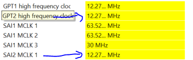

Thank you for clarifying I will keep attempting to get to this desired frequency. I have so far been able to achieve 12.279 on both exactly the same. I will let you know if I achieve the frequency you are looking for. pastedImage_1.png

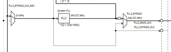

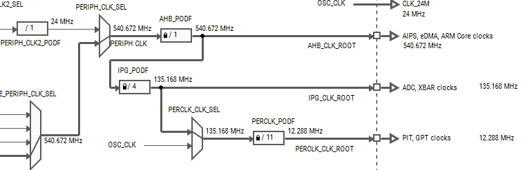

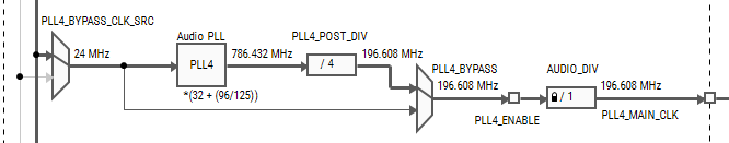

I was able to get the desired audio frequencies, with the drawback of running the core at 540 MHz instead than 600 (but I don't think I can avoid this).
Here is my configuration:
1) system PLL
2) PERCLK set to 12.288 MHz
3) Audio PLL set to a multiple of 12.288 MHz
This should be acceptable even if the frequencies come from two different clock chains.
