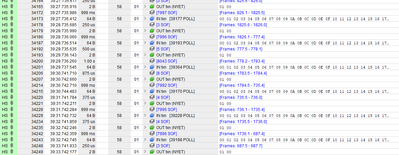

Anyway, I know this is more of a "USB question", but I need to know if I'm doing something wrong as I see "NYET" status on the OUT packets the RT1064 receives, or if this is "normal" behavior ? I have so far only worked on FS devices so the NYET on HS devices is new to me...
I checked the CDC sample from the SDK, and that one also shows "NYET" packets on each "OUT" packet, so I guess this is "just how it is" ?

NYET means that the device has indeed received the last data frame but is presently not capable of receiving further data. If you look in your recordings you will see that the host is also sending PINGs which is because it first questions whether the device can now receive data or not.
In comparison to FS USB, FS USB always ACKs successful data and the host doesn't know whether subsequent data will be accepted (ACKed) or not (NAKed). NAKs are very bad for bus bandwidth since the host has to transfer a complete frame of data for nothing and repeat it later. FS USB can therefore be bandwidth inefficient.
HS USB improves this with ACK (data was accepted and more can be sent) and NYET (data was accepted but please don't send more yet since I am not yet ready for it). After a NYET the host will use PING tokens (rather than data frames) to see whether the device is ready again or not, thus not wasting data bandwidth when it isn't.
Since you are seeing NYETs in low bandwidth cases it means that the stack is not utilising the HS USB controller's capabilities of multi-buffer descriptors. The HS USB can accept up to 16kByte of burst 480Mb/s data with no NYETs/PINGs and more if the receiver is handling the data on-the-fly and preparing more buffer space.
Therefore NYETs are normal for flow control in high data rate cases. They are also fine in low data rate cases when performance is not an issue. If they are seen in simple cases it means that the HS USB driver is not optimised for high data rate use and so may require improvements in cases where this could be of importance.

I got some of that explanation also on the net, but you explained it so I actually understood it immediately (as always when you explains something here on the forum!). Makes perfect sense. I will not need too much bandwidth anyway, so I can easily live with this "limitation", but its nice to know for the future, you never know
