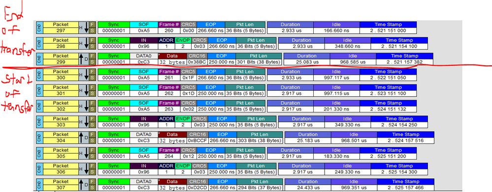

Here are descriptions of the two modes of operation. The audio bin files are 16-bit, 16kHz PCM audio, which can be played using Audacity.
Mode 1: More than one packet (greater than 34 bytes) is requested for transfer at a time
USB Trace of Audio: microphone_4k_read_usb_trace.bin.zip
Received data on RT1050 read from RAM buffer: microphone_4k_read_ram_buffer.bin.zip
a) AUDIO_BUFFER_SIZE = 34
b) The received audio’s speech is audible, but there is significant noise
c) In this mode, the audio data on the bus is equivalent to the audio data of the source (microphone)
d) Comparing the received data to the source data, bytes are rearranged and values are different
Mode 2: Exactly one packet (34 bytes) is requested for transfer at a time
USB Trace of Audio: microphone_34_read_usb_trace.bin.zip
Received data on RT1050 read from RAM buffer: microphone_34_read_ram_buffer.bin.zip
a) AUDIO_BUFFER_SIZE = 4096
b) The received audio does not resemble speech
c) The audio data recorded on the bus does not match the audio data of the source (microphone)!
d) One isochronous transaction occurs every 3ms, instead of the expected 1ms (Full Speed)
e) It seems there’s a delay in the stack that is preventing the reads from happening fast enough

Please refer to the information as the below:
I've checked the code that you provide, i'm sure that the main problem is the timing of the API USB_HostAudioStreamRecv calls. Please try to call USB_HostAudioStreamRecv in _HostAudioInCallback and set a buff that the size is at least three times packet length and call USB_HostAudioStreamRecv  more than three times to ensure that there is enough callback process time.Actually, the _HostAudioInCallback of customer's code take too much time that more than 1ms, so it appears that the packet time is too long. And that it is not recommended to do operation that cost to much time in the callback of isochronous transfer.

Update:
I was able to confirm that even when operating in Mode 1 (More than one packet is requested for transfer at a time), there is still always a 3ms delay between consecutive transfers.
I also confirmed with a spare GPIO and an oscilloscope that there is no delay between the _HostAudioInCallback being called and the state manager calling the USB_HostAudioStreamRecv function again. I believe this definitely points to there being a delay somewhere in the USB stack itself.
