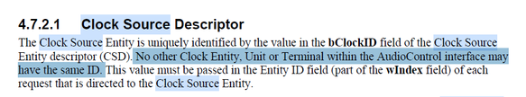

I am attempting to manually create a USB descriptor for two devices behind a single USB Audio Class 2.0 connection.  Does anyone know whether or not the Terminals, Clock and Unit should all be unique IDs when utilizing multiple Interface Association Descriptors (IAD)?  I would assume so.  Does anyone have a working example of this type of descriptor?
Below is my attempt however the linux host has complaints.  Is there someone with experience in this area to review the descriptor below?  Thank you.

jingpan
Hi @mrecoskie ,
I'm not familiar with UAC. But I see in USB Audio Class 2.0 spec, it says
Jing
