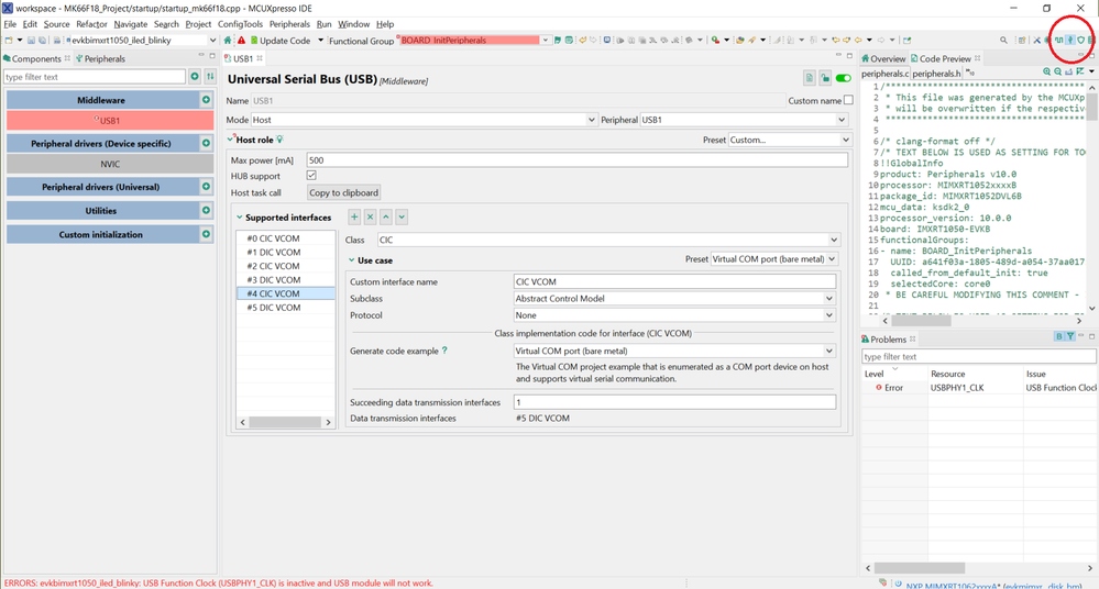

Hi @SM_98 ,
You can use the MCUxpresso Config Tools to create and add CDC interface. It's very easy. RT1064 OTG USB has up to 8 bidirectional endpoints, enough for two CDC interface.
Jing
