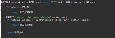

when I used the USDH1 peripheral of RT1052 to operate the sd card, I found that the USDH took too long to read and write the sd card block. The sdk version I used is SDK_2_13_0. Used is sdmmc_examples/sdcard_fatfs_freertos, sd clock is set to 198MHz, I use Sandisk 64G high-speed sdcard, sdcard correctly identified as SDR104, and fatfs file operation is normal, oscilloscope observed clk is indeed 198MHz

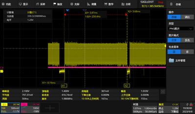

However, the underlying function sd card reads and writes the block time is too long, the theory reads two blocks (512byte*2) is 1024byte, in the four-wire case, the need for 2048 clocks, in the case of 198MHz, the theoretical need time is 1/198*2048=10.3us, But the actual operation time of the two blocks is 3.87ms (link script, code running in SDRAM and Nor Qspi Flash I have tried, the problem is the same)
This is seriously beyond normal expectations. The block read and write time is too long, so it takes 1 to 2 seconds for my upper-layer FATFS to read and write 1M files. The high-speed read and write ability of SD card is very important for the project, and I think RT series with SD3.0 peripheral performance should not be at this speed. How to solve it.

Then the CLK waveform of the oscilloscope above appeared on the oscilloscope piece by piece, and the time I indicated with the cursor

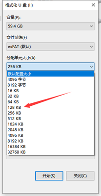

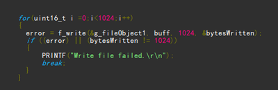

  • I found that i shouldn't be 1024 bytes every time and read 1024 times to oprate 1M,the underlying function has a minimum number of read blocks,underlying function will read or write data which its size is decided by upper function,if fatfs fuction read or write to little data,the underlying function will oprate many blocks but still return little data,it takes a lot of time.I modfy the cluster to 128K on PC,then fatfs write 1024*1024 byte,it take 41ms
  • i have a question,USDHC read and wite bock funtion like SD_ReadBlocks(&g_sd, buff, sector, count),what is the maximum count  is.The cluster value determines the maximum number of FATFS read and write blocks at a time,for example,if the cluster is 128K,FATFS can oprate 128K/512byte blockes a time when you operate data's size is more than 128K.but the cluster haves many values when formatted
