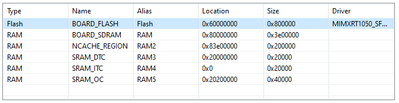

A module created for read/write to an SDCard running out of internal RAM operates properly.  When I transition to external ram (XIP_BOOT_HEADER_DCD_ENABLE=1), the program fails at SD_SendScr.  All other modules (i.e I2C, PWM etc) unrelated to uSD are functional.

the attached project functions on a custom board when DCD_ENABLED=0, however when I use the DCD and external RAM it fails.

Removing all USB PLL and USDHC register definitions from the DCD and defining clock configuration in sdmmc_config.c does not solve the issue.  When probing the SPI lines to the uSD, there appears to be a memory access issue when CMD8 should be sent.
The program running out of internal RAM functions on both the custom board and the eval board.  While operating out of external SDRAM, it fails.
