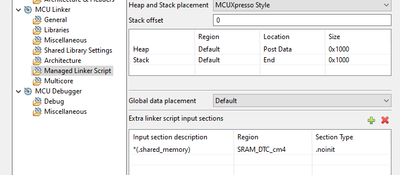

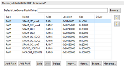

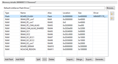

We have made the memory configuration on M7 as shown below:
M4 as shown in attched file and Memory configuration on M4 as shown below:

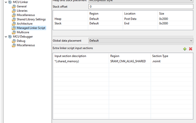

We have defined the shared memory of shared_buf[3][64KB] along with additional details for size and processed info of another 32bytes in ‘*(.shared_memory)’ section in ‘SRAM_CM4_ALIAS_SHARED’ region on M7 and ‘SRAM_DTC_cm4’ region on M4. ‘shared_buf’ is 32B aligned and starts at 0x2020e000 on both cores M7 and M4.

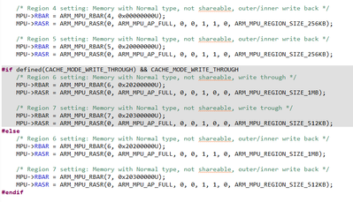

We are using the default ‘BOARD_ConfigMPU()’ function and no modifications done in the memory regions settings as shown below:
We are able access the shared memory on both cores successfully, but data changes are not reflected on either side with above mentioned memory configuration.
We tried cache cleaning functions ‘SCB_CleanDCache_by_Addr (volatile void *addr, int32_t dsize)’ before giving interrupt to M4 on M7 and SCB_CleanInvalidateDCache_by_Addr (volatile void *addr, int32_t dsize) after getting interrupt from M4 on M7 but execution becomes nearly 8 times slower.
If we change the above memory configuration to any of them as shown below and no usage of cache cleaning function, data changes are reflected properly but execution becomes nearly 8 times slower which is not desirable.
Setting-1:
Setting-2:
Setting-3:
How to achieve the data changes reflected properly with shared memory (approx. 196KB) at 0x2020e000 on both M7 and M4?

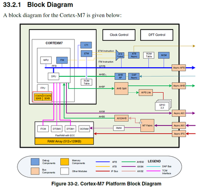

The cache does not intervene with the TCM (Tightly Coupled Memory); the cache is directly connected to the core. As shown in the next image obtained from Chapter 33.2.1 in the RM:
Also, in the chapter 2.1 in the app note called "Using the i.MXRT L1 Cache" mentions the next:
"The I/DTCM (FlexRAM banks configured as TCM) is accessed directly by CPU core, bypass the L1 cache."

As you have pointed out, we are also not sure how cache is intervening when we use TCM with cores. But we set memory region as cacheable in 'BOARD_ConfigMPU()'.
This parameter is present as it is required by the API, even if it does not affect TCM behavior. As it is ignored by the hardware (mentioned in my previous post) it does not have an impact.
When we set memory region as non-cacheable, application execution time is much slower and when we set memory region as cacheable application execution is faster, but data is not updated for both cores.
When memory is marked as non-cacheable, the processor must fetch data directly from external memory, which is significantly slower than accessing data from the cache. In contrast, cacheable memory allows the processor to store frequently accessed data in its local cache, which is much faster due to its proximity to the core.
However, cache memory is private to each core and not visible to others. This means that if multiple cores need to share data, using cacheable memory can lead to inconsistencies, since one core's cache may not reflect the most recent changes made by another.
