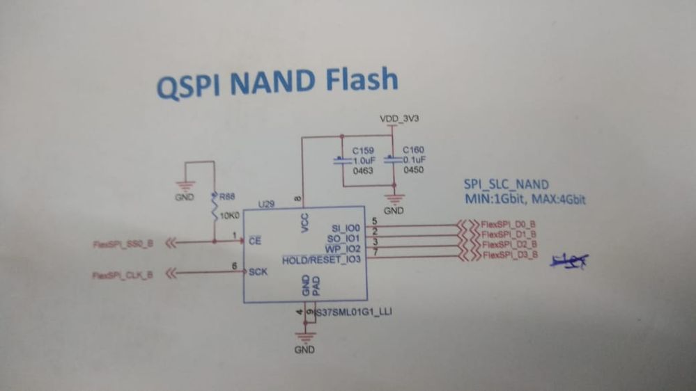

We are building a application for Serial NAND Flash(IS37SML01G01) 128MB on NXP1050 Board.

pavan_kote
Hi Kerry Zhou,
I am using our MXMRT 1052 custom board. 1Gbit NAND FLASH.
The below screenshot represents NAND connection with harware.eb1afaa3-8e16-4986-bdf4-280252bca029.jpg
As I am able to read Vendor ID and modify the status registers values.
At First i am getting Flash Erase and Page program Fail Status.
Default NAND Flash will lock all sectors and i am able to successfully remove protection.
Now i am able to erase the sector, program the Page.
But when i am reading the data i am getting garbage values.
I am using IP Command mode to communicate as reference took from NOR Code.
How to read the RX data from AHB cache or IP RX AHB Cache.
If you have any reference Please share the Serial NAND code it will be really helpful.
Pavan Kote

kerryzhou
Hi Pavan Kote,
    Can you test the read FlexSPI bus wave on your side, then compare it with the IS37SML01G01 datasheet read timing, just check whether the data on the bus is correct or not.
    About the nand flash code, I don't have it on my side, but I already help you check it from our internal side, still didn't find it, if I get any valuable information about it, I will let you know.
   In the meanwhile, I suggest you check the flexspi bus wave with read command, if the bus readout data is correct, then we need to check the code side.
Kerry
