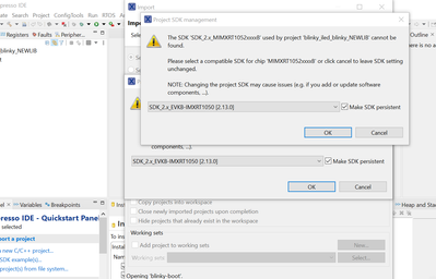

   Which SDK version you are using, I import your project, report the SDK unmatch, please tell me your used SDK version, thanks:
