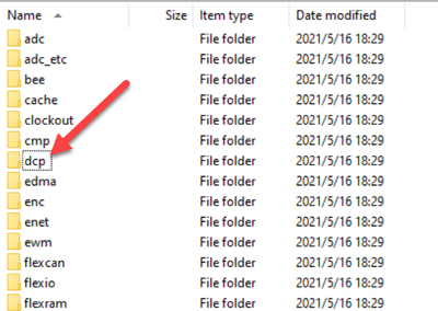

Hello NXP community,
the iMXRT10xx devices support crypto acceleration via the Data Co-processor. Is there any sample code available, especially for AES and SHA?
Thanks and best regards

Which of the examples in the SDK are you referring to? The only ones which are related to AES and SHA are the mbedTLS examples. As far as I know are these examples not using the Crypto accelerators. Did I miss something?

There's a dcp demo that resides in ~\boards\evkmimxrt1020\driver_examples of the installed SDK library directory.
