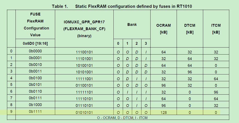

claudecdg66
its all good but an12077 dosent tell me where the memory map for the flex ram is. it dosent tell me the location neither the size to add.
16,222 Views
kerryzhou
Hi claude-david gaudreault
 FlexRAM contains: OCARM, ITCM, DTCM, and share 128KB flash.
 So, when you want to change it:
1. modify the memory map size
Change the OCRAM, ITCM, DTCM size in the following picture
2.  Modify the flexRAM code in the reset :
Take an example, you need to check the register and modify it for your own size:
FLEXRAM->TCM_CTRL = 4;
IOMUXC_GPR->GPR17 = 0x5AAFFAA5;
IOMUXC_GPR->GPR16 |= 0x7;
IOMUXC_GPR->GPR14 = (9<<20) | (8<<16) ;
3. modify the .scp for your own memory size
You can find the .scp in folder:
C:\nxp\MCUXpressoIDE_11.1.0_3209\ide\binaries\Scripts
an exmaples for your, you still need to modify the related data

4.  Modify the stack location from end to start
More details, you also can check this question post:
FlexRAM and Linker Problem
Wish it helps you!
If you still have questions about it, please kindly let me know.
Kerry

kerryzhou
Hi claude-david gaudreault,
   If need to modify the flexRAM to the new size, it's really a little complicated.
   or you can define some of your code to the other RAM, eg ITCM or DTCM, otherwise, your OCRAM is overflowed now.
Kerry
   OCRAM in default is 64KB, your code should already overflow it.
   You may try to define some larger RAM code to the ITCM or DTCM.
   Or you can enlarge the OCRAM size to 128KB, and disable the DTCM and the ITCM.
   More details about the flexRAM modification, you can refer to the application note:
https://www.nxp.com/docs/en/application-note/AN12077.pdf
Wish it helps you!
Kerry

claudecdg66
Here for example is the memory map from the evkmimxrt1010dev_audio_speaker_bm example. We can see that in this example it allow more OCM than TCM but its still not enough to use the fatfs and codec in the same code. How do i arrage this map in order to get enough on chip ram for my project.
16,222 Views
kerryzhou
  That's why I suggest you disable the DTCM, ITCM, juse use all the flexRAM for OCRAM, about how to conifugre the flexRAM, please refer to this application note which I already share with you:
Wish it helps you!
Kerry
