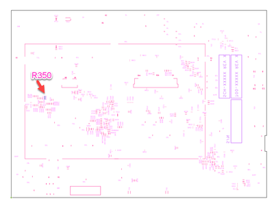

I have the MIMXRT1060-EVKB board.  I note on the Zephyr page for MIMXRT1060-EVK  (not B) in mentions to use SPI  it is necessary to solder zero ohm resistors at R278, R279, R280 and R281.
Questions about SPI resistors:
Am I also required to solder the resistors on MIMXRT1060-EVKB (B revision) board?
Is there a diagram that shows the location of these resistors, there are literally hundreds of them!

Hi @anthony_asterisk
Thanks a lot for your patience.
Yes, to enable SPI on J17 you need to solder those resistors.
By the way to find resistors, I usually see the layout printed on a PDF. Download the RT1060-EVKB design files and navigate to this path  MIMXRT1060-EVKB-DESIGN-FILES.zip\MIMXRT1060-EVKB-DESIGNFILE-RevB1\Layout
I hope this helps you!

Looking at the schematics for EVKB, it appears the resistor numbers have changed.
On the Arduino Interface page, the resistors for EVKB appear to be R356, R350, R346, and R362.
Please confirm if these are correct.
2,182 次查看
diego_charles
Diego
