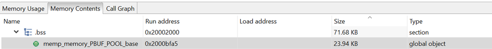

From mem.c, this specifies LWIP heap usage. And I can move to SDRAM (0x8xxxxxxxx) if needed to free up SRAM_DTC:
#ifndef LWIP_RAM_HEAP_POINTER
/** the heap. we need one struct mem at the end and some room for alignment */
LWIP_DECLARE_MEMORY_ALIGNED(ram_heap, MEM_SIZE_ALIGNED + (2U * SIZEOF_STRUCT_MEM));
#define LWIP_RAM_HEAP_POINTER ram_heap
But I still see LWIP allocating a lot of stack when I examine the image. How do I move memp_memory_PBUF_POOL_base ?

For instance, you can move the memp_memory_PBUF_POOL_base object to the SDRAM after the below configuration.

Is there something I can change in memp_std.h to move PBUF_POOL?
* A list of pools of pbuf's used by LWIP.
* LWIP_PBUF_MEMPOOL(pool_name, number_elements, pbuf_payload_size, pool_description)
* creates a pool name MEMP_pool_name. description is used in stats.c
* This allocates enough space for the pbuf struct and a payload.
* (Example: pbuf_payload_size=0 allocates only size for the struct)
LWIP_MEMPOOL(PBUF, MEMP_NUM_PBUF, sizeof(struct pbuf), "PBUF_REF/ROM")
LWIP_PBUF_MEMPOOL(PBUF_POOL, PBUF_POOL_SIZE, PBUF_POOL_BUFSIZE, "PBUF_POOL")
4,377 Views
