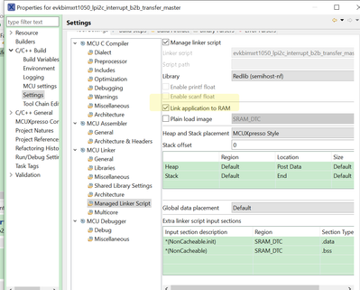

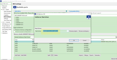

I'm using LPC-LINK2 Debugger and I had selected MIMXRT1050_SFDP_QSPI as flash driver.
The SDK driver seems to work with SRAM_DTC but results in SWD 0 devices detected when flash is selected as primary memory.

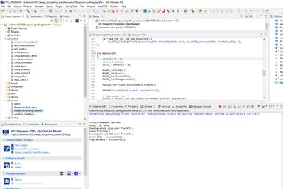

Testing with SDK_2.9.1_EVKB-IMXRT1050\boards\evkbimxrt1050\driver_examples\flexspi\nor\polling_transfer
Yes, I had first tested the flash with this SDK. It seems to work fine.
Only for this SDK example it doesn't seem to work with Flash

1. Please run SDK_2.9.1_EVKB-IMXRT1050\boards\evkbimxrt1050\driver_examples\flexspi\nor\polling_transfer
And share me your test result, please note, this project run from the RAM.
Then send me your printf result. I need to make sure your external QSPI really works OK, and you also enable the QE bit, this is important.

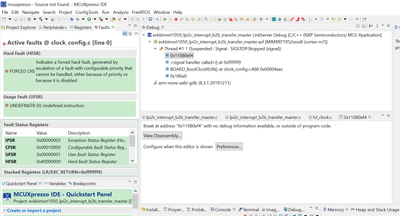

I have one MIMXRT1050-EVKB board which I have modified it to the QSPI flash, then I run your attached project directly , this is my debug result:
you can find, I can enter the debug mode the first time, without your mentioned SWD issues.
Then run it, your code meet fault issues, then the SWD can't be connected.
So, mainly your modified code issues,  I think you can do the external memory erase at first, then run the SDK code for this project without modification again, it should works.

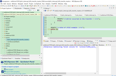

Your main issue is caused by your own modified code, this is the SDK debug result:
You can modified the code again based on the SDK project.

2. import one SDK evkbimxrt1050_lpi2c_interrupt_b2b_transfer_master_SDK project
I've followed all your steps.
I've imported new SDK example  and just changed the slave address and pin muxing, with no modification
It resulted in the same error SWD 0 devices detected.

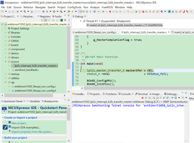

Kindly note with Flash chosen as the primary memory , debug never enters the main, and it results in SWD 0 Devices for the second time of the debug.
But when SRAM_DTC is chosen as primary memory, it enters the main function.
The debug enters the main function but it doesn't write to the slave.
