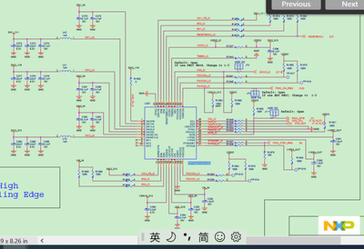

We are developing a board with RT1175 and MPF5020CMMACES.
Where can I find a reference design schematic, or some docs?
Please note that I read AN13213, but there is only the PMIC portion of the schematic there, I also need the reference design for RT1175.
I am convinced that NXP had to develop a board to test MPF5020 with RT117x. I wish I could see the schematics of that board.
In addition to this I would need a software reference design.
I need to know if I need to set any fuses to tell the rom bootloader that I am using an external PMIC instead of the internal DCDC, for example.
I also need to know how to set config tool for the external PMIC so that it does not generate code that the internal DCDC uses instead.

Hi @mastupristi ,
  Our MIMXRT1170-EVKB already have the PMIC.
This is the related design file:
https://www.nxp.com/webapp/Download?colCode=MIMXRT1170-EVKB-DESIGNFILES
Wish it helps you!
Kerry
