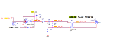

I'm planing to receive and then postprocess some S/PDIF-data with the RT1024
As I'm at the very beginning and never have used NXP before: can anybody recommend a good starting point? What development resources are available to implement this (in bare metal) on the RT1024?
Or - by any chance - are there ready-to-use libraries/frameworks available which already do the job of receiving S/PDIF-data?

  Normally, when you want to use one IP, you need to read the chip RM about the SPDIF at first, then about the code. As I know, the RT1024 SDK didn't add the SPDIF, but our RT1170 SDK add it, you can refer to RT1170 SDK code:
The SDK download link:
https://mcuxpresso.nxp.com/en/select
This is the related SPDIF circuit:
You also can find it from the MIMXRT1170-EVK board schematic.
As the MIMXRT1024-EVK board didn't add the SPDIF circuit.
Kerry
