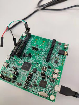

I'm running into issues with UART on the MIMXRT1010-EVK board.
When i connect a FTDI cable (3.3V) to the following pins:
Connected FTDI TX to J56 pin 2 (LPUART1_RXD)
Connected FTDI RX to J56 pin 4 (LPUART1_TXD)
connected a shared ground
I see this behavior:
When FTDI TX is connected the dev board has issues booting (device enters into maintenance mode).
if TX is removed it boots fine (also see the bootup hello world output).
Note: I used the standard "hello_world" example from NXP.

Please follow the below steps to set the hardware connection.
1) Removes the jumpers on the J31 and J32;
2) Connects FTDI TX to J56 pin 2 (LPUART1_RXD) and FTDI RX to J56 pin 4 (LPUART1_TXD), meanwhile connects a shared ground(as the figure shows);
3) Power on the EVK board;
4) Plug the FTDI into the USB port on the PC;
5) Click the SW9 to reset the MCU to make the MCU boot up again.
After that, you can see the outputted string and it works well on my board.
TIC

Thanks I also realized that the debug USB also comes up as COM so i can get access via testing that way as well.
However I still have one pending question:
Why does a reset of the board need to occur after the FTDI cable is installed? Our product will be using a UART solution and I want to make sure that our chip doesn't come up in a bad state on bootup in our custom PCB.
Thanks for the help!
Nate

Thanks for your reply.
1) Why does a reset of the board need to occur after the FTDI cable is installed?
-- Actually, the step is not necessary, it's used to make the MCU reboot to print out some string to confirm the hardware connection is good.
