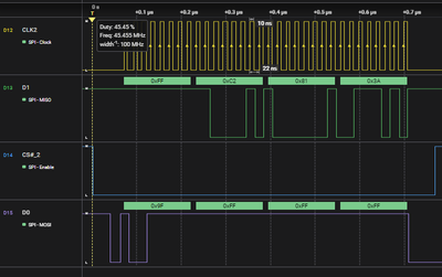

Running example evkmimxrt685_flexspi_octal_polling_transfer, on EVK685
Running from RAM, semihost for debug.
When running command Read Jedec ID, opcode 0x9F in SPI 1-1-1 for read 3 bytes,
when using kFLEXSPI_ReadSampleClkLoopbackFromSckPad or kFLEXSPI_ReadSampleClkExternalInputFromDqsPad, extra byte is read, while when using kFLEXSPI_ReadSampleClkLoopbackInternally, only requested 3 bytes are read.
see attached logic capture, and source code:
kFLEXSPI_ReadSampleClkLoopbackFromSckPad, 4 bytes are read, while requesting only 3:
kFLEXSPI_ReadSampleClkLoopbackInternally, only 3 bytes are read:

I'm facing the exact same problem. When reading 32bit from FPGA over QSPI. It works using the "kFLEXSPI_ReadSampleClkLoopbackInternally" read strobe. The LUT entry is the following:
 - kFLEXSPI_Command_RADDR_SDR, kFLEXSPI_4PAD, 12 /* bits */
 - kFLEXSPI_Command_DUMMY_SDR, kFLEXSPI_4PAD, 1 /* cycles */
 - kFLEXSPI_Command_READ_SDR, kFLEXSPI_4PAD, 4 /* bytes */
 - kFLEXSPI_Command_STOP, kFLEXSPI_1PAD, 0
It writes the 12bit address: 3*4bits, then 1*4bits of dummy cycle, following with 32bit = 8*4bit read data.
This is a sum of 3+1+8=12 SCK clocks in SDR mode
When enabling "kFLEXSPI_ReadSampleClkExternalInputFromDqsPad" an additional 6 SCK clocks are appended after the read data clocks and before CS is asserted high. The read data is valid, but we lose 50% of our throughput.
Is there any solution to this problem?

Hi Omar,
The LUT match expected operands and sequence.
Your answer doesn't explain why on using RT685EVK with FlexSPI example, setting
#define EXAMPLE_FLEXSPI_RX_SAMPLE_CLOCK kFLEXSPI_ReadSampleClkLoopbackInternally
or:
#define EXAMPLE_FLEXSPI_RX_SAMPLE_CLOCK kFLEXSPI_ReadSampleClkLoopbackFromSckPad
with same operation sequence,
with ClkLoopbackFromSckPad settings, we are getting extra 8 clocks, which is the failure,
and with ClkLoopbackInternally settings, clock count is as expected.
see attached pictures, and zip files with source code using evkmimxrt685_flexspi_octal_polling_transfer_cm33 example.
Please escalate this issue to R&D.
LUT_statusLUT_statusSrc_Clk_LoopbackFromSckPadSrc_Clk_LoopbackFromSckPadSrc_Clk_internallySrc_Clk_internally
