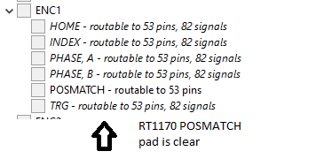

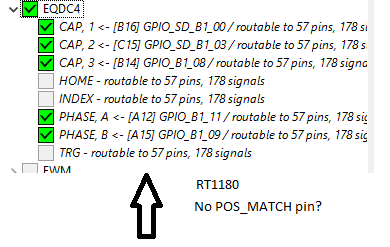

Hi NXP,
With the RT1180, which CPU pads can be used for eQDC output signal POS_MATCH?
Grateful for any assistance at this early stage in the RT1180 life cycle.
Kind regards,
Mark

Hi @padmoz ,
Thanks for your interest in NXP MIMXRT series!
For the RT1180, XBAR is required for configuration. You can choose the following signals as input signals for the XBAR, the output signals are more free:
The corresponding output PADs can also be found in RM.
Gavin

Hi Gavin,
Great, thanks for your help.  I've got the pins routed successfully through XBAR now.
