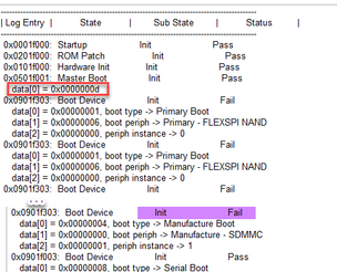

Using the "NXP MCU Boot Utility" to check the boot log for both our custom board and the EVK we see the following logs:
0x0001f000: Startup Init Pass
0x0201f000: ROM Patch Init Pass
0x0101f000: Hardware Init Init Pass
0x0501f001: Master Boot Init Pass
data[0] = 0x0000000c
0x0901f303: Boot Device Init Fail
data[0] = 0x00000004, boot type -> Manufacture Boot
data[1] = 0x00000000, boot periph -> Manufacture - SDMMC
data[2] = 0x00000001, periph instance -> 1
0x0901f003: Boot Device Init Pass
data[0] = 0x00000008, boot type -> Serial Boot
data[1] = 0x00000011, boot periph -> Serial - UART/USB HID
data[2] = 0x00000000, periph instance -> 0
0x0902f001: Boot Device Call Pass
The EVK shows correctly booting from FLEXSPI NOR with this section as the relevant difference:
data[0] = 0x0000000d
data[0] = 0x00000001, boot type -> Primary Boot
data[1] = 0x00000005, boot periph -> Primary - FLEXSPI NOR
How should we interpret these logs?

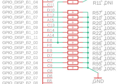

I appreciate that you checked already the SBMR1 (0x40C04008) I wonder regarding the contents  of the SBMR2 . Could you let me know about them?

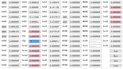

I understand that you are using  boot config pins  to override for the BOOT_CFG1 fuses. You have not burned other fuse on the chip already, correct?
We could also consider if on your custom board the  boot config pins  are shared and used to drive other signals on your custom board. Is this the case? Would you be able to share an schematic portion corresponding to this?
Let me know if there is any other detail we could be missing.

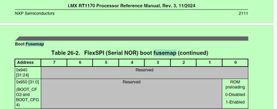

Here is a screenshot of the fusemap scanned with the NXP MCU Boot Utility:

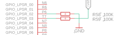

Here are the relevant boot-mode pins in the schematic:
And the boot-config pins:
They are not used for any other signals.

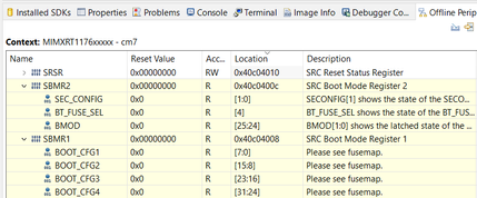

Thank you for your reply! I have been checking your redouts from your custom board.

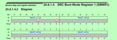

For SBMR1 40C04008 =  09 00 00 00 you have some reserved bits of  BOOT_CF4  turned on.

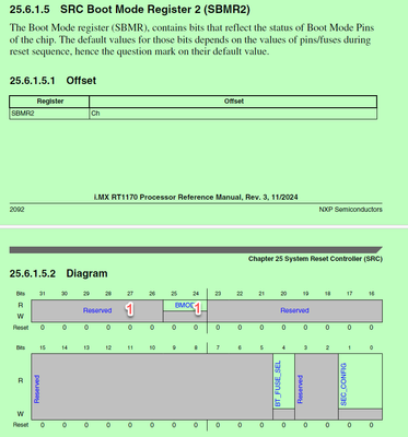

For SBMR2 40C0400C = 09 00 00 00, my interpretation is that  you are getting boot mode (BMOD) set to serial downloader mode 0b01 and reserved bit 27 on.
If you program a image on your custom board,  and the boot with  boot mode pins to internal boot (0b10)  are you still getting BMOD bitfield set  serial downloaded mode (0b01)? . If yes, this can be seen as if the bootROM kept executing and  the XIP image was never attempted to boot, or is not valid/corrupted.

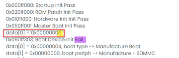

The problem lies on data[0] = 0x0000000c, and not  0x0000000d
According to our team, below three settings are valid to make sure that data[0] begins with  0xd
1. SRC->SBMR2[25:24] = 2'b00,  SRC->SBMR2[4]=1
2. SRC->SBMR2[25:24] = 2'b10
3. SRC->SBMR2[25:24] = 2'b11, Fuse 0x960[3] = 1

Your log from the failed board.
       I can also see that BootROM only attempts to boot from Manufacture boot and data[0] end with ends  0x0000000c. I could not replicate this situation.
Then, while my  MCU was still into serial downlaoder, I attached to the SWD and manually read the SMBR2, I was able to get the following readout: SBMR2 = 0x0200_0009
