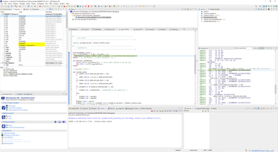

We have a custom i.MXRT1170 board which we are able to load code onto and it functions correctly. However this is only the case if we load and execute code from RAM. When attempting to load code into FLASH the stack seems to be completely missing (0B used) and then it tries to return and gets a stack overflow. Loading the same code onto the EVK results in it working correctly.
Attached are photos of the code in the same place on the working EVK and the custom board with the stack overflow.

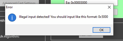

zhudson22
Yes, all of our boards are exhibiting the same behavior.
When I rename the .dat file to a .bin file the mcu boot utility gives me an error for "illegal input detected"
I have attached the file (in a zip because of upload limitations)

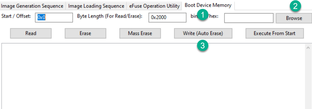

jeremyzhou
Please follow the below steps to program this bin file.
