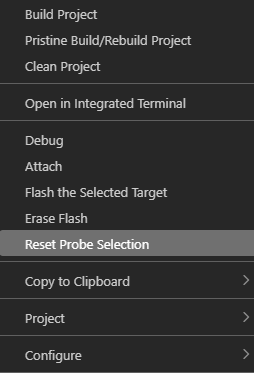

I have a project based on the freeRTOS multicore message buffers example from nxp SDK.
There seem to be a problem with the LinkServer Flash Programmer in the mcuxpresso for vs code extension.
I am sometimes able to flash the m7 firmware which loads the M4 to the correct ocram adress. Very often the flash programmer fails and the board stops running it's code.
What is the cause of this and how can I fix it so that I'm always able to flash the m7 correctly?
Thanks!

1,990 Views
cyberhelmer
I do have have latest firmware for the MCU-Link.
Resetting the probe before a flash as you suggested does not make a difference unfortunately. Still get this error most of the time:
