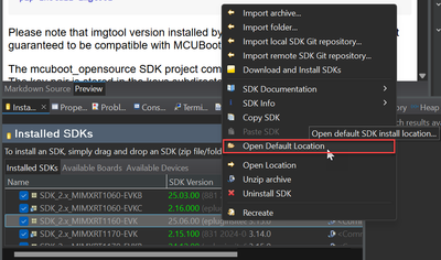

I cannot find "middleware/mcuboot_opensource/scripts folder."
Could you give me more information?
Ken
1,074 Views
Habib_MS
Hello again @kensu,
Absolutely! First, you will need to locate your SDK file. To do this, right-click on the "Installed SDKs" window in your development environment.
Once you have identified the SDK for the RT1160-EVK, open the corresponding .zip file. Inside, you will find the scripts located at: <mcu_sdk>.zip\middleware\mcuboot_opensource\scripts
