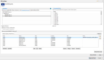

I've changed the MCU settings to point BOARD_FLASH to flex spi 2A:

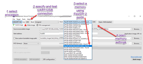

Use the  MCUboot Utitliy or the MCUXpresso Secure Provisioning Tool (SPT) With the SPT. Below some steps with the SPT
1   Set MCU into serial downloader mode.
2 Open the SPT and do the below config.
3 Edit memory settings and run the TEST option. This will invoke bootloader APIS and try to write that configuration on your flash memory.

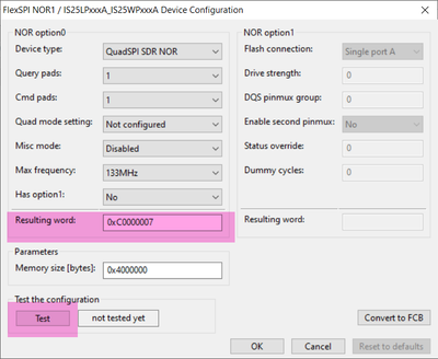

Hi Diego, thanks for your help.
I tried the Secure Provisioning Tool and was able to successfully test the flash:

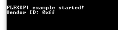

However, I can't get flexspi_nor_polling_transfer to work. I see "Vendor ID: 0xff" in the debug console, and then it hangs at FLEXSPI_TransferBlocking:

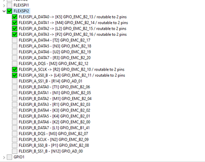

These are the FlexSPI2A pins I'm using:
And I changed the app.h to match:
Any idea what I'm missing with the example project?

I can't tell if the FlexSPI2 A pins are setup correctly within the config tools. Are you linking all the project to SRAM?  In which function does  the program actually halts?

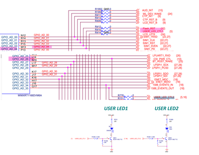

I think that the MCU boot utility application should toggle a RT1160 EVK user LED1 or user LED2. With  the schematics of the EVK, you should see check which GPIO pins are connected to the user LEDs

I was able to program the blinky image using SPT and then halt the MCU and see that I'm in the 0x6xx xxxx space. I can also see the LED1 pin toggling (no LED on our board).
