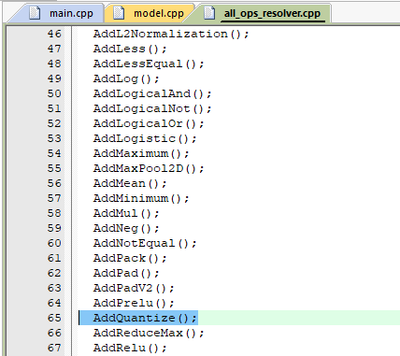

     In order to optimize the code size,  the newest sdk(sdk 2.10.0) usually registered the nodes needed, so if you change a model ,you need to re-register the nodes inside your model:
   So, please help check, if your code is using the line:71 to include all the op-codes into the project not the line 73 of the model.cpp:
     And also please check if there is a function named AddQuantize() inside all_op_resolvers.cpp:
    Crist
