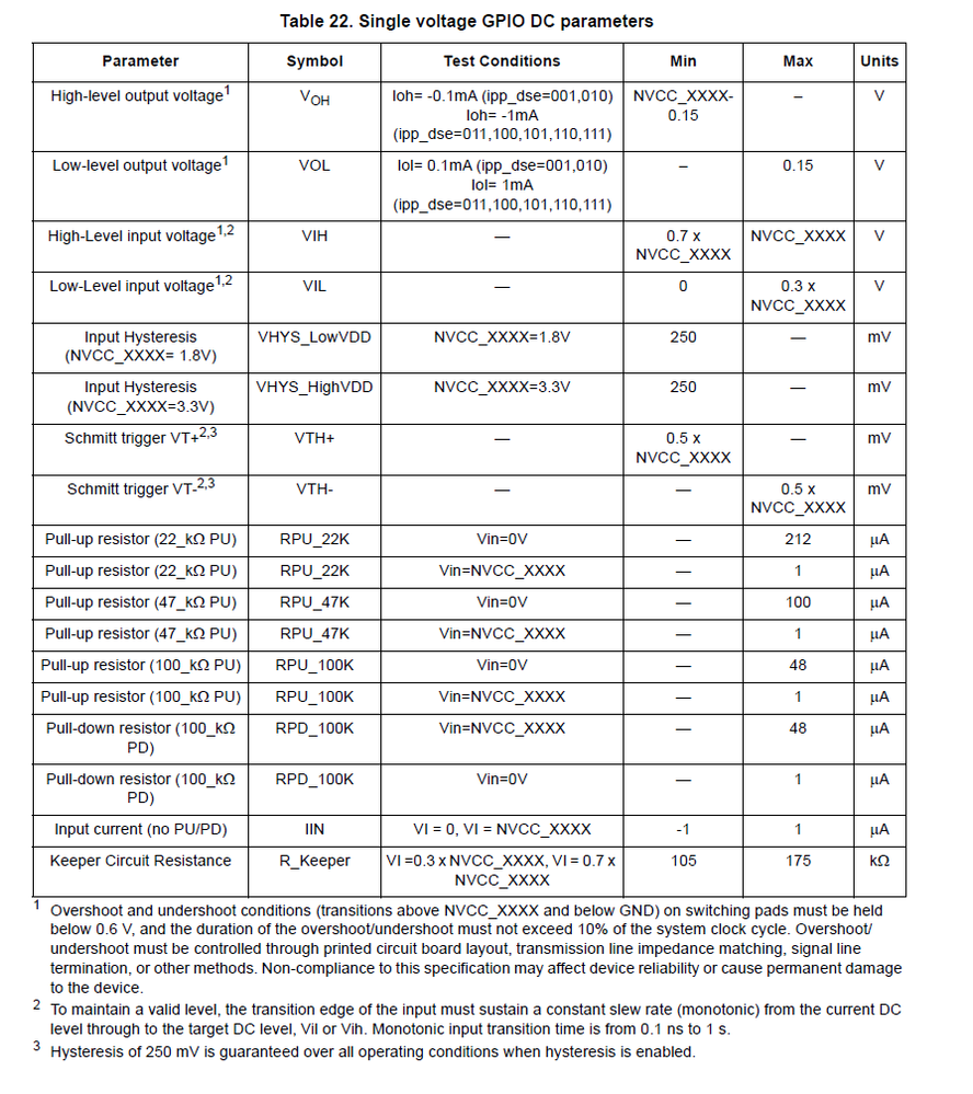

I've been trying to verify if the iMX RT1062 is 5v tolerant. I've read through all the available docs here, but can't seem to find a mention:
i.MX RT1060 MCU/Applications Crossover Processor | Arm® Cortex®-M7 @600 MHz, 1MB SRAM | NXP

Its not. According to datasheet, inputs must not exceed NVCC (overshoot is max 600 mV) and max NVCC is 3.6V.
