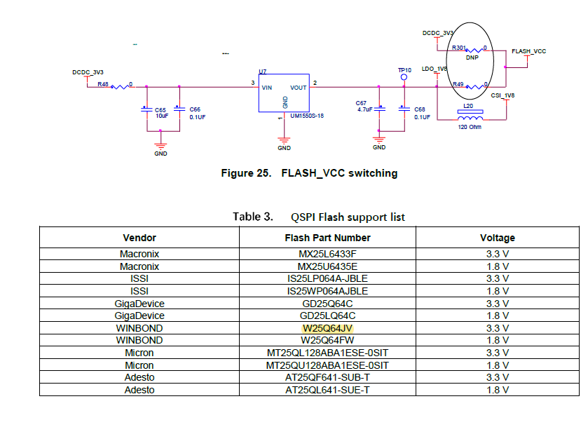

It's a new design board for me,The flash is  IS25lP128.  Whether the Flexspi_nor_polling_transfer example  have a link?

Hi Customer,
    From application note AN12108, your QSPI flash is not supported directly in the list:
So, you can try the QSPI in the list, when it work, it means your hardware do't have problem, then you can try to modify your own qspi flash.

dimitarmarinov
We had a similar problem with our QSPI flash. We had to configure the maximum drive strength for the QSPI pins to R0/7 (Maximum). We also reduced the clock from 120 MHz to 100 MHz.

dimitarmarinov
The board is our custom board. The flash is W25Q32JV. Yes, we tried with the Flexspi_nor_polling_transfer example. Now, after the mentioned modifications, QSPI flash works fine.
