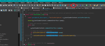

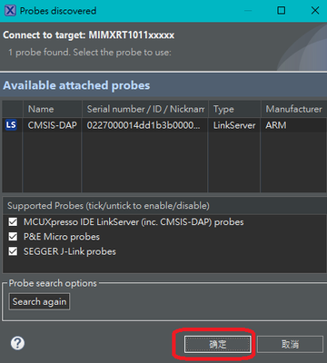

  I was flash NXP evkmimxrt1010_flashloader sample code to RT1010 EVK ,
but the result was fail. Attached is my flash error log. Could you give me any advice or help?

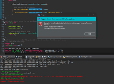

NXP: MIMXRT1011xxxxx
DAP stride is 1024 bytes (256 words)
( 65) Chip Setup Complete
Connected: was_reset=true. was_stopped=true
( 70) License Check Complete
File 'evkmimxrt1010_flashloader.axf' load failure: Ef(11). No flash configured at the specified address.
(100) Target Operation Failed
Unable to perform operation!
Command failed with exit code 1

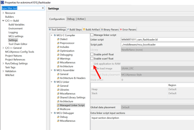

Here is my IDE and SDK version, and I have try this on different workspace, but it still can't work.(I got this SDK from https://mcuxpresso.nxp.com/en/dashboard)

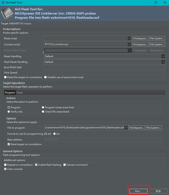

Following is my building and flashing method .
Build
Flash

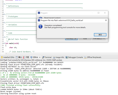

I've tried other sample project(Hello_world  & iled_blinky) and they seem to work fine

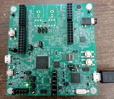

The following is the configuration status of my EVK board

Hi @Omar_hong ,
Hope you are doing well!
In fact, this is because the flashloader project is a project that links to RAM and does not need to flash to external memory. The GUI tool you are using tries to do this and then reports an error. If you want to run the demo, just use the Debug button in the shortcut tool.
