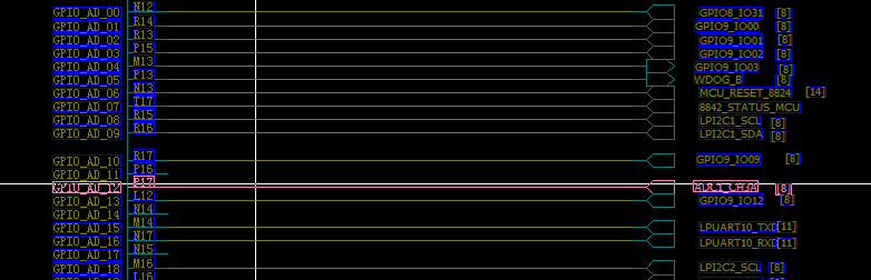

ywjack
Hi:NXP TechSupport,I had a similar problem,I used the ADC1 [N13] GPIO_AD_06 CHANNEL0 and [P17] GPIO_AD_12 CHANNEL3 of the LPADC module, and I found that the ADC value of CHANNEL0 is correct, and the ADC value of CHANNEL3 is always 4095. But I'm using SDK_2_12_1_MIMXRT1170-EVK.zip SDK, so I think there may be something wrong with my configuration. Could you please help me check it
Here is my configuration

ywjack
https://community.nxp.com/t5/i-MX-RT/ADC-ETC-CFG-Problem/m-p/1548202#M22343
I have attached my code project below this link, sorry that I should not have wasted your resources by consulting different technical support on this issue, sorry (because I can't get it out, about ADC1A_CH3(P17)) he always read 4095, I think there is something wrong with my configuration

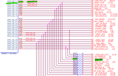

Pavel_Hernandez
I desist to make the report I review the schematic, are you using the EVK? let me show why the ADC1_3 is not available on the board.
Is using as input for the ENET interface.
Pavel

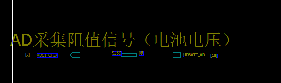

ywjack
I do not use the DEMO board of NXP EVK. I use the LAYOUT board of my company.1.png1.png2.png2.png微信截图_20221115190842.png微信截图_20221115190842.png
