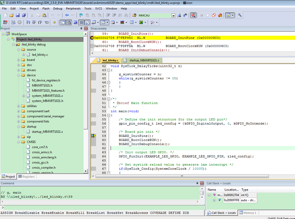

I use  i.mx rt1020 evk board.I was donwloading example projects  smoothly to the board,but then  flash error was started to give .
Keil mdk 5.24.2
Error: Flash Download failed  -  Target DLL has been cancelled
3,479 Views
kerryzhou
Hi bilge kara,
     Please check your MIMXRT1020-EVK board back side, find the SW8, power off the board, then change it to:
     SW8_1 OFF
     SW8_2 OFF
    SW8_3 OFF
    SW8_4 ON
   Then use the USB cable connect j23, connect the debug button on the MDK, I am using the SDK code:SDK_2.5.0_EVK-MIMXRT1020\boards\evkmimxrt1020\demo_apps\led_blinky\mdk
  This is the test result:
  You can try it on your side.

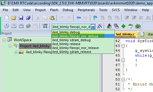

  If you want to download to the external qspi flash, choose this item:
Then press the LOAD button, after the download is finished, then power off the board, change the SW8 to :
     SW8_1 OFF
     SW8_2 OFF
    SW8_3  ON
    SW8_4 OFF
  Power on the board again, you will find the on board D5 is blinking, it means it works OK.
Please try it again on your side.
