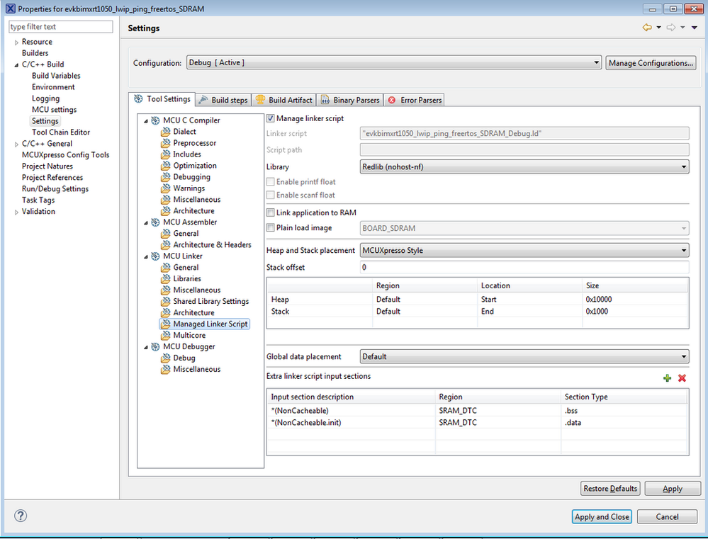

I reviewed the same FreeRtos version of the bm example (evkmimxrt1020_lwip_udpecho_freertos) and here I found some examples of where caching is needed and/or disabled in order to have lwip working.   As a consequence I will use this example as a reference for I need and so I think this answered my question

In cases you are using OCRAM as your main RAM, For LwIP I would suggest you put some key data structures to SRAM_DTC or other non-cacheable region.

ENET buffers need to store in SRAM_DTC
Original definition:(enet_ethernetif_kinetis.c)
    SDK_ALIGN(static rx_buffer_t rxDataBuff_0[ENET_RXBD_NUM], FSL_ENET_BUFF_ALIGNMENT);
    SDK_ALIGN(static tx_buffer_t txDataBuff_0[ENET_TXBD_NUM], FSL_ENET_BUFF_ALIGNMENT);
Change to:
  AT_NONCACHEABLE_SECTION_ALIGN(static rx_buffer_t rxDataBuff_0[ENET_RXBD_NUM], FSL_ENET_BUFF_ALIGNMENT);
  AT_NONCACHEABLE_SECTION_ALIGN(static tx_buffer_t txDataBuff_0[ENET_TXBD_NUM], FSL_ENET_BUFF_ALIGNMENT);
