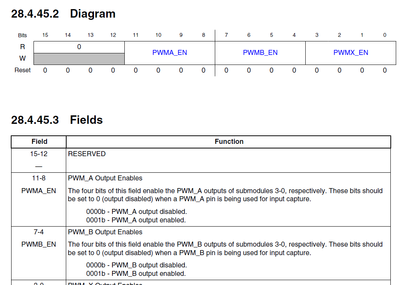

I suggest you clear the corresponding bits in PWM OUTEN register, which will disable the PWM signal output, but the PWM module continues to work.
You can use the code to write the register.
PWM2->OUTEN=0x00;
If you connect a external pull-down resistor or set the PWM signal pin as pull-down mode, the pin will be low logic.
Hope it can help you
XiangJun Rong

gary_metalle
Thanks for taking the time to reply.
Yes that does work. I am surprised the fsl_pwm PWM driver doesn't have a function to set/clear the OUTEN bits if this is something that is obviously important.
I am also confused as to why I needed to add an external pull-down resistor because all the PWM pins have a 100K pull-down enabled in the pin configuration. I am assuming that this pull-down is still used when the pin is configured for PWM and not a general purpose GPIO?

xiangjun_rong
I suppose that you can set SW_PAD_CTL_PAD_xxx register to enable on-chip pull-down resistor to get low logic of the PWM pin when the PWM outputting function is disabled. But it is a common design to connect pull-down resistor for each PWM pins.
