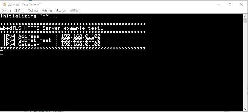

Step 8. Connect RT1060 EVK to COM10 and it will show the following messages.

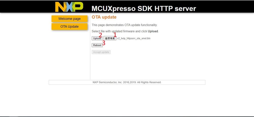

 Step 9. Upload "v2_lwip_httpssrv_ota_enet.bin" by GUI
After Reboot, click "Accept Update"
The console will show the "update_image_state(3): 0".
And Reboot again, we will show the application already change to v2 app.
Step 10. But if I would like to upload "v1_lwip_httpssrv_ota_enet.bin" bu web GUI again, it will shown the "Image validation failed".
