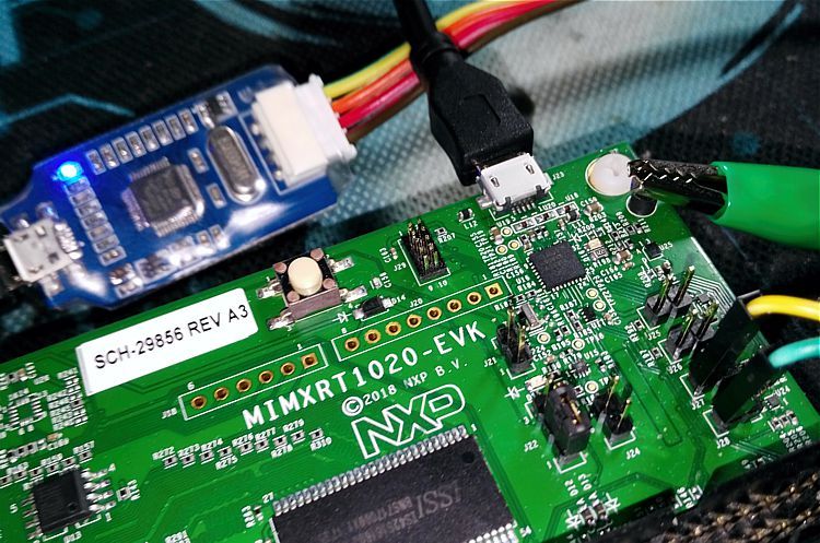

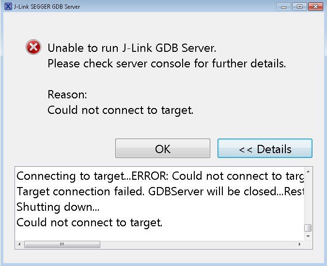

Today I received my Jlink OB, to try to Program/Debug the RT1020 microcontroller directly, without using OpenSDA/Daplink that installs the evaluation board.

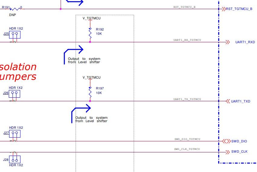

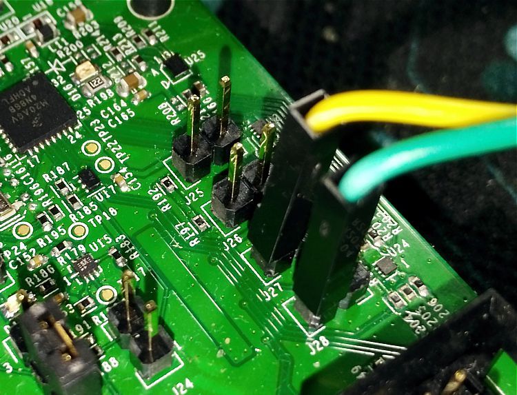

I have removed the jumpers that connect SWDIO and SDCLK to OpenSDA (J27--> SWDIO, J28--> SWCLK ), and I have connected those signals and GND to the Jlink OB. MCUXpresso recognizes the Jlink, but fails to connect to the microcontroller.
There are three more jumpers in the evaluation board (J24, J25 and J26), two are for a UART and one for the RST signal. If I remove these jumpers, and use OpenSDA-DAP Link via USB or JTAG work well, it seems that the UART is not useful to program and debug, I do not know what is the utility of this serial port, but it is not essential for debugging or program.

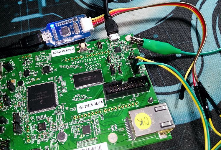

I also tried to connect my Jlink V9 by SWD directly to the RT1020 and it also fails. I do not understand why I can not connect directly to the RT1020 microcontroller by SWD using a Jlink, when the OpeSDA (based on Kinetis MK20) on the evaluation board is also connected via SWD to the microcontroller.

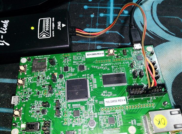

It works for me, connecting the SWD cables to the JTAG connector, I do not know why it did not work when I plugged into the J27 and J28 jumpers, in theory both also go to the SWD signals of the JTAG connector.
In any case, I prefer to use JTAG, because someone told me, in the MUConEclipse blog, which is faster than SWD. I will use my Jlink V9, and on my custom board I will put a 2x5 or 2x6 IDC connector, of the 1.27mm step with a flat cable.

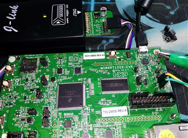

I've done a new check right now. I have connected Jlink to JTAG J16, I have removed all jumpers J24 to J28, and it works, I can program and debug.
I have reviewed the evaluation board schematic several times, and I do not see how it connects directly from JTAG to RT1020, it seems that all the JTAG lines go to the Kinetis MK20 instead of the RT1020, so I thought that the MK20 was acting intermediary in all cases.
Now I need to know how many pins this JTAG connection needs to program / debug the RT1020. I only want the essential, if it could be by SWD with 2 or 3 pins, better.

CarlosCasillas
Hi Luis,
Yes, J16 was the key, it is where external JTAG should be connected.
In case of having troubles when switching between connections on MCUXpresso IDE, you could try deleting the current connections (.launch files), and creating news on autodetect mode

I see in the scheme of the evaluation board, that JTAG connects directly to RT1020, and then I can design my own board with a JTAG 2x5 or 2x6 IDC connector and a flat cable to connect to Jlink or Multilink PE.
One more question, please.
Can I connect to RT1020 microcontroller by SWD to program and debug? I've tried with SWCLK and SWDIO, but I do not know if I also need the RESET pin because if I remove the RESET jumper of OpenSDA/DAP-Link in the evaluation board, it still works with just those two signals (SWCLK and SWDIO). But when I try to connect with a Jlink OB or Jlink V9, using the same two signals (SWCLK and SWDIO), removing J27 and J28, to connect directly to RT1020, then it does not work.
I can program and debug by JTAG, but it fails when I try to use SWD (with a Jlink OB and Jlink V9), although it seems that OpenSDA is connected by SWD with RT1020. I do not understand how OpenSDA connects by SWD with the microcontroller, and I can not do it using a Jlink V9 or Jlink OB.
