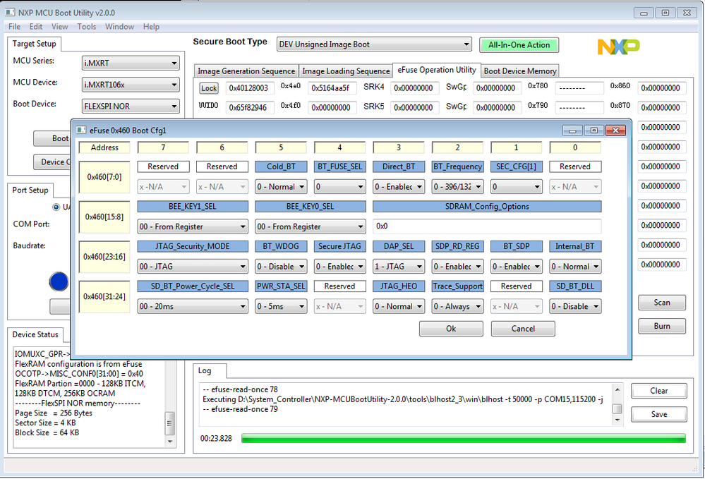

I am having an imxrt1060 EVK board and used NXP MCU Boot Utility to set JTAG interface to JTAG mode from SWD, but now I am not able to connect to board in normal mode using JTAG/SWD mode and also not able to set DAP_SEL bit to 0 for SWD mode

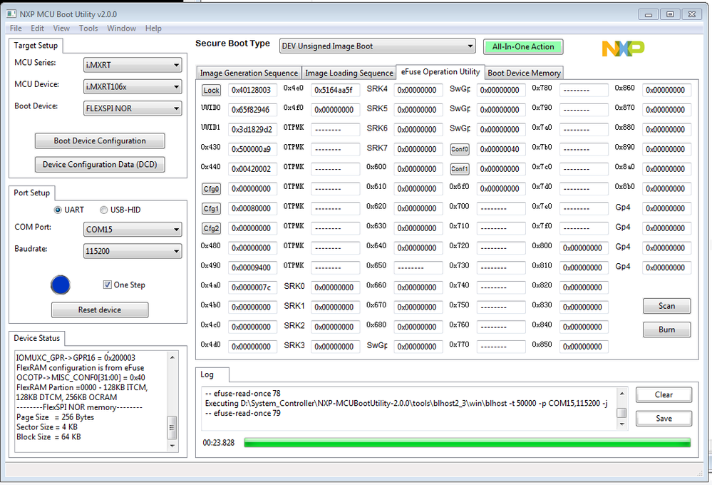

1. Can you read out those eFuse data and paste here?
2. Can you use j-link Commander and try to connect cortex-M7 core?

1. Below is a screenshot of eFuse data

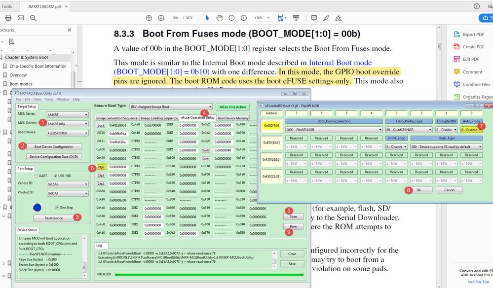

jingpan
Please try to boot from eFuse.

jingpan
Hi Amit,
What you write is in eFuse. It is an OTP memory. Only can write from 1 to 0.
The on board CMSIS-DAP firmware doesn't support JTAG. So, you have to use external debugger tool.
Jing

amitmehta
Hi Jing,
I have written 1 into DAP_SJC_SWD_SEL bit to configure JTAG interface into JTAG mode, after that I tried to connect using 20 pins onboard SEGGER header available on EVK, but I was not able to connect even after setting IAR Embedded workbench JTAG interface into from SWD to JTAG mode. even tried using J-Flash tool.
I am only able to communicate to the board using the NXP MCU Boot Utility.
