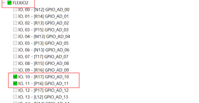

i am trying to bring up two flex uart interface in my project. I could configure one flex uart very easily but when it came to bringing up second flex uart i am not able to. Can anyone help me out with this. i am using flexio2 for both the uarts as my board only has one usable base. i cant use flexio1. i will attach screenshot of my configuration parameter along with this post.

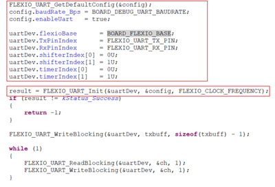

Please import "evkbmimxrt1170_flexio_uart_polling_transfer_cm7".
This demo uses FlexIO2 for UART, You can refer to this routine to initialize the UART settings.mayliu1_0-1727599390877.pngmayliu1_0-1727599390877.png

The mcu i am using is i.MXRT1189. And my question is can we bring up one more flex uart using same instance. I have already bought up one flex uart with instance flexio2 and i am using it with a gsm module. i have setup pin 2 and 3 as rx, tx pins for this. I need one more flexuart for other purpose but with same instance and 18,19 as rx and tx pins respectively. Can i do this?
i have already tried this but i am having issue. i have configured uart in interrupt mode for both uart.

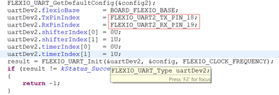

Yes, you can bring up one more flex UART using same FLEXIO instance.
I have a few suggestions for you:
1:You need config PIN and clock setting, maybe you can use MCUXPresso IDE PIN config tool.
2: I suggest modify code for FlexIO UART2, next code is just demo code
please try it.
