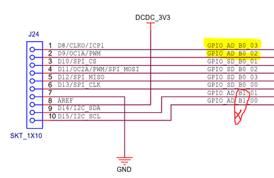

I have now spend several hours trying to figure this out and I am not sure what is going on.
What I want (as a first step for later more complicated triggering schemes):
Take a signal from one pin and directly output it on another pin via XBAR.
I am using pins D15 and D14 on the Arduino Headers of the i.MX RT1064 Evaluation Kit which I have setup using the pin configuration tool of MCUXPresso like so:
pin M14 | D15 | GPIO_AD_B0_00 acts as XBARA1 Input 14
pin H10 | D14 | GPIO_AD_B0_01 acts as XBARA1 Output 15
My code besides the auto-generated code is quite simple, in the main loop I call:
XBARA_Init(XBARA1);
XBARA_SetSignalsConnection(XBARA1, kXBARA1_InputIomuxXbarInout14,kXBARA1_OutputIomuxXbarInout15);
I expect to see the input signal on D14 () which is a square wave to be output on D15 ().
However, I see nothing...Any clues to what is going on?

Dear Mark,
thanks a lot for taking the time and checking this. I think I figured out what happened:
The Eval-Board apparently has an error in the schematic for header J24 Pins 9/10 D14/D15.
The routed signals are GPIO_AD_B1_00 and GPIO_AD_B1_01, but they "should" be GPIO_AD_B0_00 and GPIO_AD_B0_01.
Here is my thinking:
- pins GPIO_AD_B1_00 & 01 are already routed to J23 and it seems illogical to route the same pins twice to the Arduino headers
- the MCUXpresso IDE thinks those header pins are connected to pins M14 and H10, i.e. GPIO_AD_B0_00 & 01, which would make more sense to route to J24 when looking at the other pins routed to J24.
There is definitely a mismatch between MCUXpresso IDE and the schematic.
I didn't double check the signals in the schematic since MCUXpresso so far has worked fine...leason learned.

I just set up the code in the uTasker project for the RT1064:
POWER_UP_ATOMIC(2, XBAR1_CLOCK); // ensure that XBAR1 is powered
IOMUXC_GPR_GPR6 &= ~(IOMUXC_GPR_GPR6_IOMUXC_XBAR_DIR_SEL_14); // ensure XBAR_INOUT14 is an input
_CONFIG_PERIPHERAL(GPIO_AD_B0_00, XBAR1_INOUT14, PORT_DSE_MID); // select XBAR_INOUT14 on GPIO1_IO00 (GPIO_AD_B0_00) alt. function 1
IOMUXC_GPR_GPR6 |= (IOMUXC_GPR_GPR6_IOMUXC_XBAR_DIR_SEL_15); // set XBAR_INOUT15 as an output
_CONFIG_PERIPHERAL(GPIO_AD_B0_01, XBAR1_INOUT15, PORT_DSE_MID); // select XBAR_INOUT15 on GPIO1_IO01 (GPIO_AD_B0_01) alt. function 1
XBAR1_IOMUX_XBAR_OUT15(XBAR1_IOMUX_XBAR_INOUT14_IN); // connect the XBAR_IN14 input to XBAR_OUT15
and ran the simulation and GPIO_AD_B0_01 followed GPIO_AD_B0_00.
Then I loaded the code to the EVK and wanted to verify on D15 / D14 of the headers but couldn't find the signals there. Instead these are GPIO_AD_B1_00 and GPIO_AD_B1_01.
These pads have no XBAR function and so maybe you misread the circuit diagram?
Mark

For completeness I also tested a version (simulation and on EVK HW) for D9 and D8:
IOMUXC_GPR_GPR6 &= ~(IOMUXC_GPR_GPR6_IOMUXC_XBAR_DIR_SEL_16); // ensure XBAR_INOUT16 is an input
_CONFIG_PERIPHERAL(GPIO_AD_B0_02, XBAR1_INOUT16, PORT_DSE_MID); // select XBAR_INOUT16 on GPIO1_IO02 (GPIO_AD_B0_02) alt. function 1: J24-2 on EVK
IOMUXC_GPR_GPR6 |= (IOMUXC_GPR_GPR6_IOMUXC_XBAR_DIR_SEL_17); // set XBAR_INOUT17 as an output
_CONFIG_PERIPHERAL(GPIO_AD_B0_03, XBAR1_INOUT17, PORT_DSE_MID); // select XBAR_INOUT17 on GPIO1_IO03 (GPIO_AD_B0_03) alt. function 1: J24-1 on EVK
XBAR1_IOMUX_XBAR_OUT17(XBAR1_IOMUX_XBAR_INOUT16_IN); // connect the XBAR_IN16 input to XBAR_OUT17
Therefore my conclusion is a mis-read of the diagram and the code itself is fine and operational
Mark

MultipleMonomials
Hmm, maybe this an EVK rev A thing?  I know that on the MIMXRT1050 EVK rev A, they routed the signals like this, and then they changed it to AD_B1 signals because D14 and D15 need to support I2C to comply with the Arduino pinout (even though it means those signals are on the headers twice).
