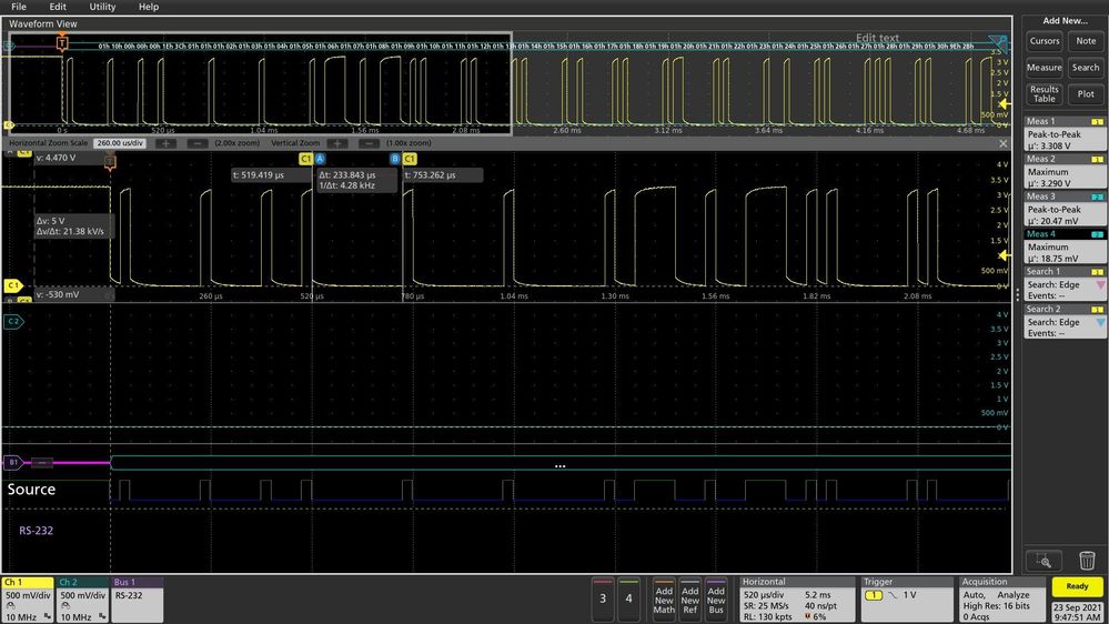

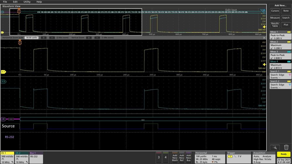

creatorwonny
I checked the frame with oscilloscope and there seemed no delay between data.
[ NORMAL ]
RX:000910-01 10 00 00 00 1E 3C 01 01 01 02 01 03 01 04 01 05 01 06 01 07 01 08 01 09 01 10 01 11 01 12 01 13 01 14 01 15 01 16 01 17 01 18 01 19 01 20 01 21 01 22 01 23 01 24 01 25 01 26 01 27 01 28 01 29 01 30 9E 2B
TX:000911-01 0 00 00 00 1E 40 01
[ ERROR ]
RX:000912-01 10 00
RX:000913-00 00 1E 3C 01 01 01 02 01 03 01 04 01 05 01 06 01 07 01 08 01 09 01 10 01 11 01 12 01 13 01 14 01 15 01 16 01 17 01 18 01 19 01 20 01 21 01 22 01 23 01 24 01 25 01 26 01 27 01 28 01 29 01 30 9E 2B

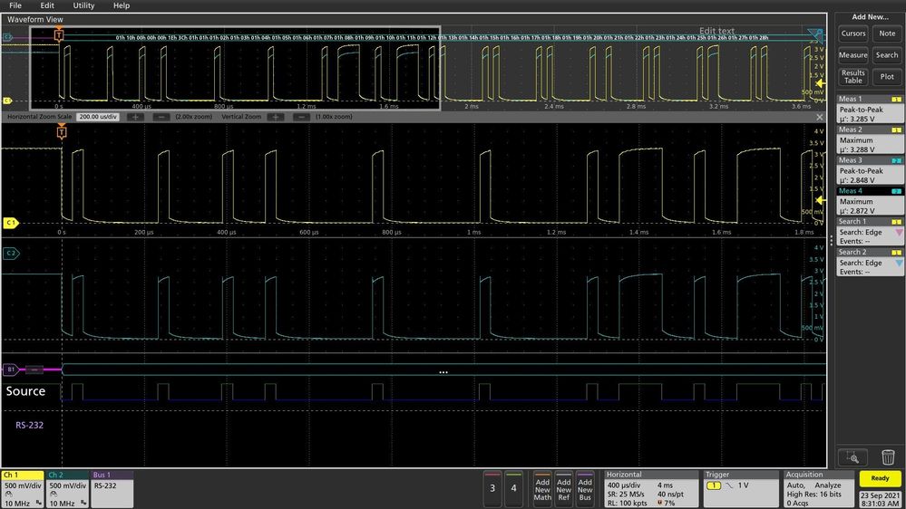

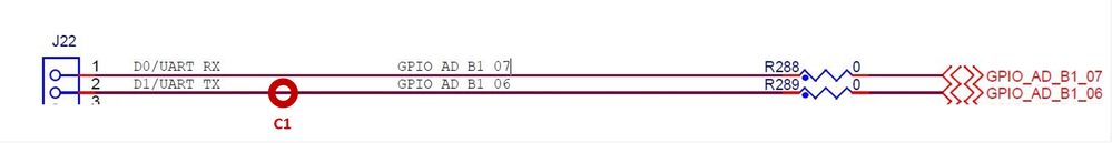

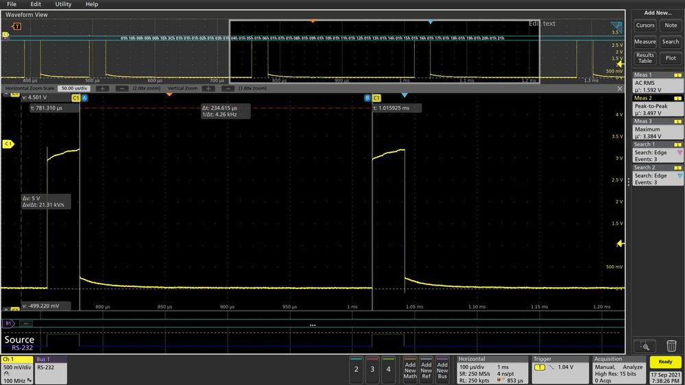

The above is the log data that the modbus slave received and there was a case that modbus slave recognized one packet as two packets and I captured the signal of GPIO_AD_B_07 pin when it happened. The time for each character was about 235us and no problematic delays were observed.

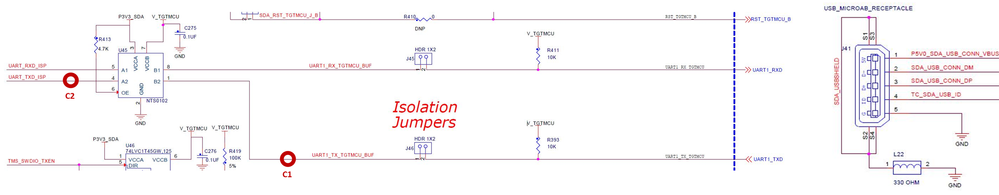

I tested and captured on UART1 and there wasn't problematic delay either. But there was difference in communication. As I mentioned, communication with the pins of UART_TXD_ISP after NTS0102 worked well. However communication with the pins of UART1_RX_TGTMCU before NTS0102 (remved jumper on J46) had the same issue like UART3. Should we use a chip like NTS0102 in order to communication with PC using USB-TO-SERIAL cable?

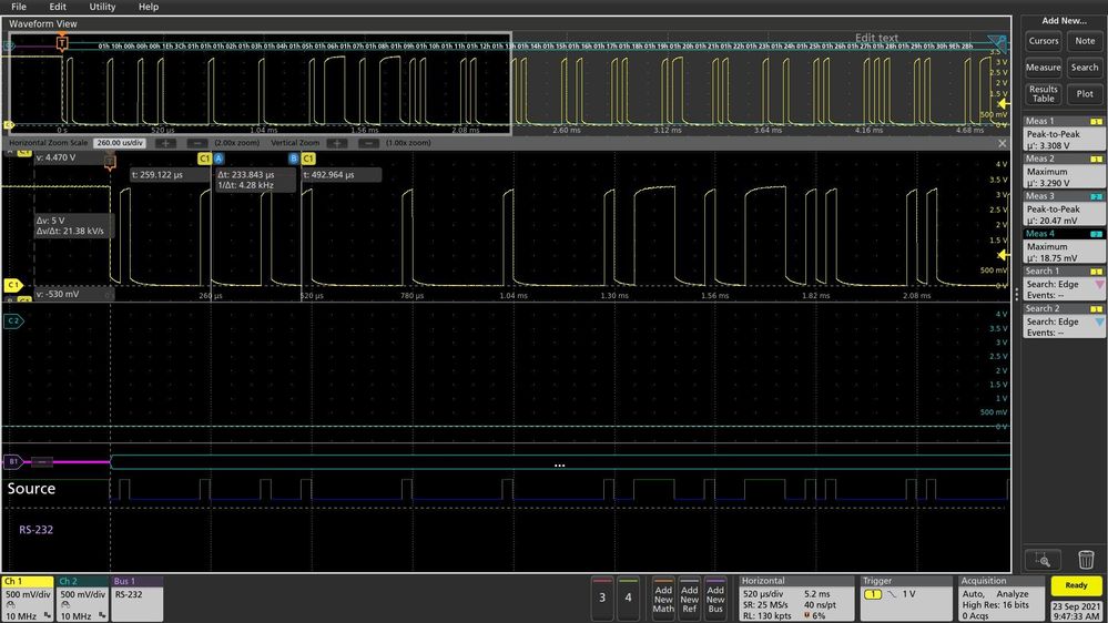

Here are some more information about this issue.
I captured the two points of the signals in UART1 and it communicated with PC through a USB cable which is connected to J41 on iMXRT1060 EVK. In this case, the communication is working well without any issues.
Rx:000060-09:59:54.612-01 10 00 00 00 1E 3C 01 01 01 02 01 03 01 04 01 05 01 06 01 07 01 08 01 09 01 10 01 11 01 12 01 13 01 14 01 15 01 16 01 17 01 18 01 19 01 20 01 21 01 22 01 23 01 24 01 25 01 26 01 27 01 28 01 29 01 30 9E 2B
Tx:000061-09:59:54.612-01 90 02 CD C1

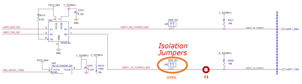

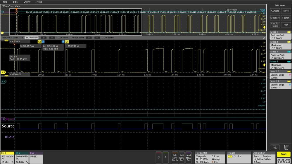

However, if I use UART1 with J46 jumper opened then it has the same issue.
Rx:000078-10:04:36.168-01 10 00 00 00 1E 3C
Rx:000079-10:04:36.201-01 01 01 02 01 03 01 04 01 05 01 06 01 07 01 08 01 09 01 10 01 11 01 12 01 13 01 14 01 15 01 16 01 17 01 18 01 19 01 20 01 21 01 22 01 23 01 24 01 25 01 26 01 27 01 28 01 29 01 30 9E 2B

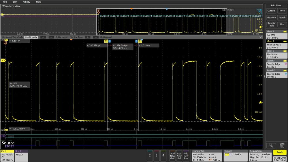

In addition, UART3 also has the same issue.
Rx:000243-10:45:53.893-01 10
Rx:000244-10:45:53.926-00 00 00 1E 3C 01 01 01 02 01 03 01 04 01 05 01 06 01 07 01 08 01 09 01 10 01 11 01 12 01 13 01 14 01 15 01 16 01 17 01 18 01 19 01 20 01 21 01 22 01 23 01 24 01 25 01 26 01 27 01 28 01 29 01 30 9E 2B
[ evk_uart3_rs232_error_003.jpg ]
[ evk_uart3_rs232_error_004.jpg ]
For more information, I attached all files that captured the signals. I hope I can get any idea  about this issue.
