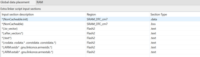

I'm working on the iMXRT1176 using MCUXpresso IDE, need to add 2 new parts with existing Board Flash.
For example, Memory A (0x30000000), Board Flash (0x30040000), Memory C (0x30080000) it is done within the MCU settings (properties).
Question:
     Now My code's text section needs to map to Board Flash. How to do it?

Hi @KAVIN_M ,
Thanks for your interest in NXP MIMXRT series!
We recommend you to check this post first, he will help you in your application scenario: https://mcuoneclipse.com/2021/05/26/placing-code-in-sections-with-managed-gnu-linker-scripts/

I read it and shifted my section from Flash 1 to Flash 2 (refer the img).
But in debug.ld still the content in the Flash 1 remains the same. Then the %age used in clear
Is it ok to accept this as correct change ?
